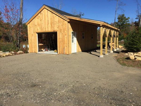

    Had this 16x28 barn put up this summer. It's 16x28 with a 10x28 lean-to for a total footprint of 26x28.
    Slab was $3200, entire barn (including roof, doors, etc...everything) was $8000 for a total of $11,200.
    PS: theres a second overhead door opposite the one in the pic, 3 Windows on the back wall and an 8' loft
