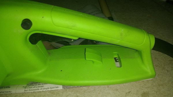

    Can't figure out for the life of me what the hook is for on my electric chainsaws. My google searches led me to believe it's called a cord retention hook, but the cords are only a foot long, and if I were to keep the extension cord with it during storage, I'd need another point on the saw to wrap it around.
    What is it really for? How is it supposed to be used?

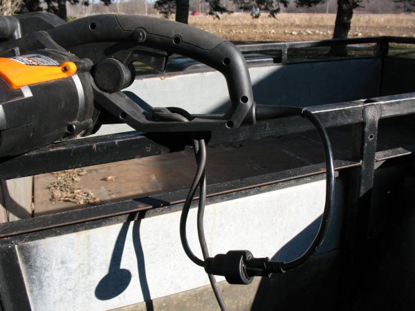

    They are to retain the extension cord. A small loop on the female end of the extension cord is passed up thru the hole in the saw and placed over the hook. The saw cord is then plugged into the extension cord.

    My 12 gauge extension cord won't go through either the hole in the handle, nor under the hook, as I played around with it to try out your description. But I think I understand, and appreciate your response, it'd probably work with a 16 gauge cord.

    x2, it secures the extension cord to saw so your not pulling on the saw cord.

    Pic of cord retainer usually only fits lighter cords.

    Thank you! This picture is exactly what I was looking for. I've been using a 12 gauge cord, but doubt that it's necessary. You solved my mystery.
