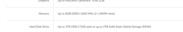

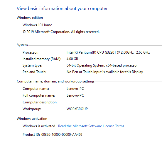

    I've been using a newer MS Office Suite often lately, as well as Acrobat Reader, my computer bogs down and stalls for way too long often. If it falls asleep, forget about it, can be 30 minutes with cpu light lit up.
    Could more memory solve this?
    Here is what I found on my computer
    Here are specs I found from manufacturerLenovo C460 All-in-One | Entry-Level All-in-One PCs | Lenovo UK
    Think I can another 4gb and would that solve the stalls? DDR3 1600mhz ?

    Thanks Dave, that price is worth a shot (and yes, a shame it can only take 4 more).
    Ordered, will be here monday, hope it helps but I might just need a newer/better computer. Cracks me up, I remember paying for 256 and 512 memory and being ahead of the game. Times change.

    I think you are mixing RAM and disk space in your thoughts when you ask about uninstalling Libre to improve MS Office performance. Libre might have a small “quick start” program taking up a little bit of RAM, but the part of Libre sitting on the disk is like having an extra car in the garage - it won’t affect your other cars’ performance (unless your disk is more than 85% full).
    Put another way, the 8GB is like your actual desk top in your office, where your active work gets laid out, and your hard disk is a file cabinet out at the end of the driveway. The slowness you are seeing is due to Windows shuffling things back and forth from your desk out to the file cabinet. Making your desk space (RAM) larger reduces the time spent swapping data and programs. Removing something from the file cabinet generally won’t help.
