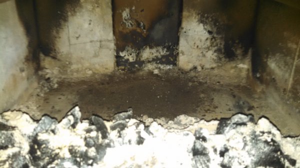

    Stove dropped out yesterday afternoon with the warm front so I took the opportunity to do a spring cleaning of the box this morning Normal vacuum work in the front air channel and vacuumed up above the fire bricks. Figured I would take a peak at what might be lurking atop the fire board. Tough to get a good look or tool to clean it off, but figured out a good method. Take one board and slide it across the top of the other. Move both boards toward the center before sliding one board all the way across the other to allow the ash to fall into the stove, not onto the ledge. Now swap so the bottom board is the top and repeat. I found a ton of fine ash atop the boards No doubt the air flow was restricted. That is after 3 seasons of burning.

    Sorry, thought it was in the sig. NC30 Englander. Bet many of the EPA non-cats are of similar design.
