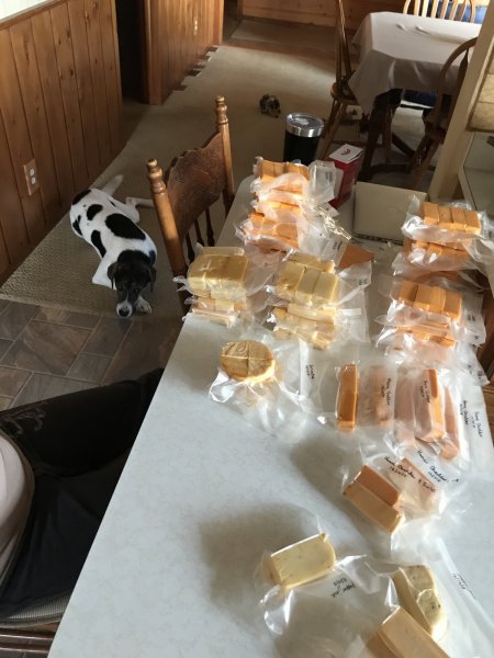

    My sister had some of my smoked cheese and took it to a work party, this is the cheese order from the party and some for our local friends. I’m going to scale back the operation, I don’t want to take the fun out of it. 1EE52AA8-EBF1-4238-A0C2-F174726584A9.jpeg

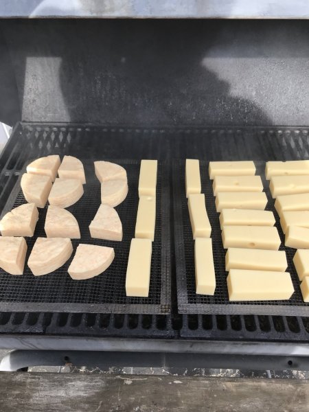

    More cheese is on the smoker. Swiss and Sriracha Jack. I’m building my stock up in good cheese smoking weather. February and 10 degrees isn’t my favorite temp to smoke cheese. E53CA4EF-F0F2-4CAD-8CDA-D1A35C6A44ED.jpeg

    Smart move! Better to smoke when it's cool out...instead of well below freezing.
