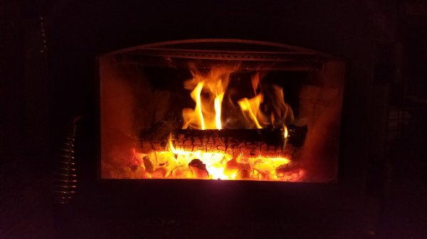

    I've been burning a lot of Mulberry now that it's gotten nice and cold, and it leaves chunks are hard, smoldering coals once it's burned down. I have been scooping them out almost daily since the firebox starts to get filled up within just a few days, but I know there's still a lot of BTUs trapped in them things. Now don't get me wrong, it's been awesome for the matchless reloads, but I need way to get these things to burn down. I've heard someone mention that Pine will help chew through coal buildup...is that the case? Thanks in advance, and enjoy these rolling secondaries as a token of my gratitude.
