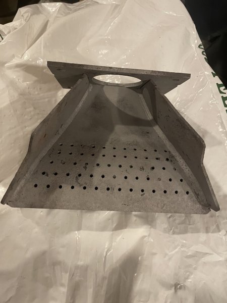

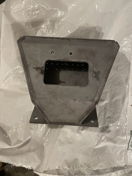

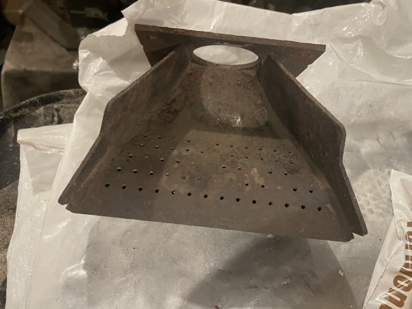

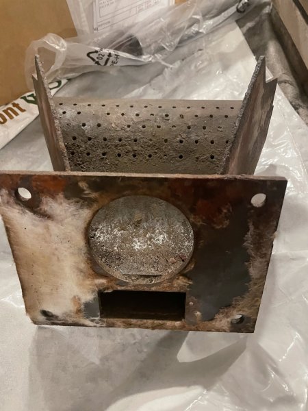

    The Harman P61 has not been used in the past 4 years and the Burnpot and Burnpot Gasket is a little grundgey!

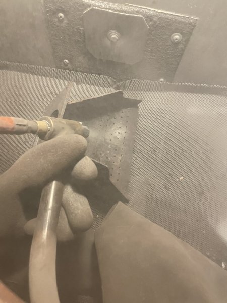

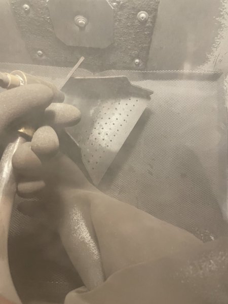

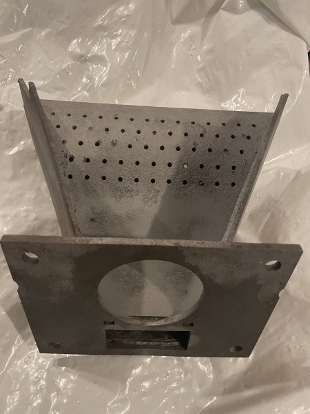

    Using a blasting cabinet with a little white aluminum oxide and 25 CFM Quincy compressor seemed to perk it up a bit?

    I run multiple burn pots in my 6039's, one in service and the other in a bucket of water with a little Simple Green in it. Couple days soak and all the grunge (and hard carbon) comes right off with a little putty knife work and some coarse Scotchbrite. Same applies to the stirrers.

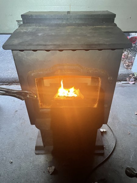

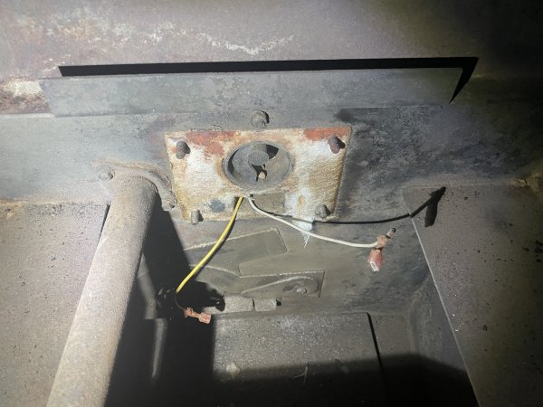

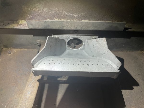

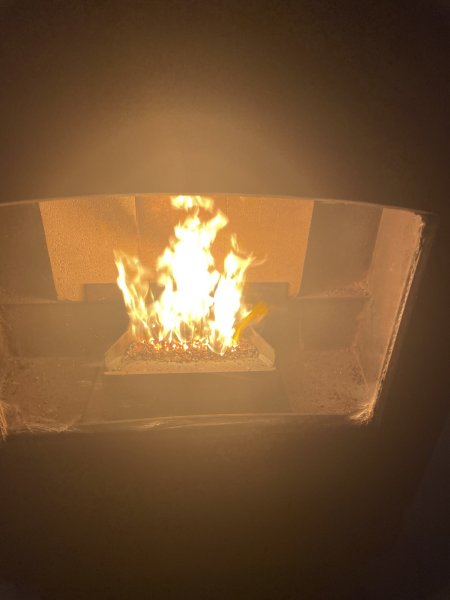

    Here is the new burnpot gasket and burnpot installed and stove working like new!

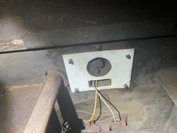

    Funny thing is a few years ago I was having problems with my stove and come to find out there was a warp on the back wall of my stove so I ended up having to put 2 burn pot gaskets on and has worked amazing ever since. That burn pot looks nniicceee.
