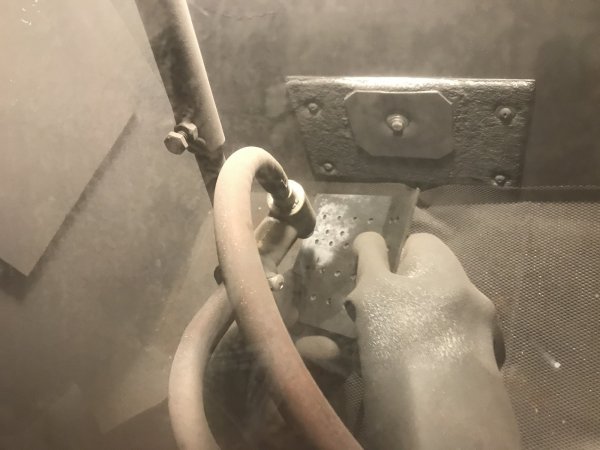

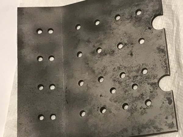

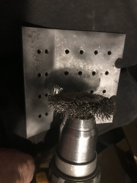

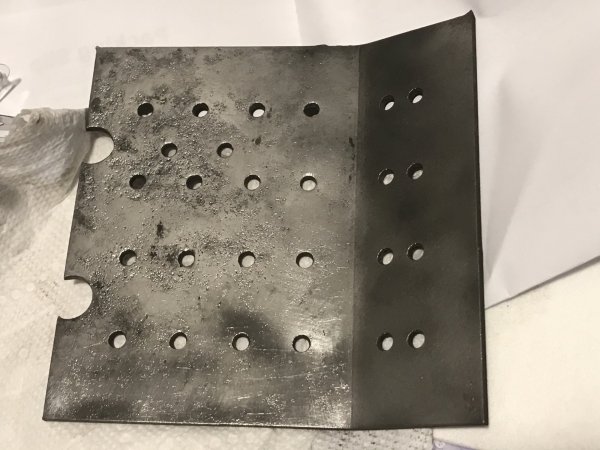

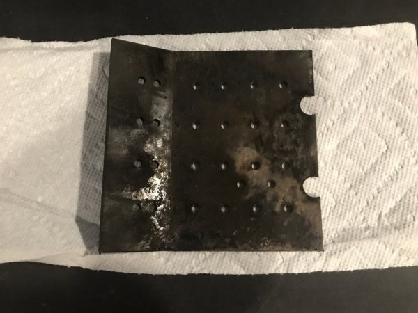

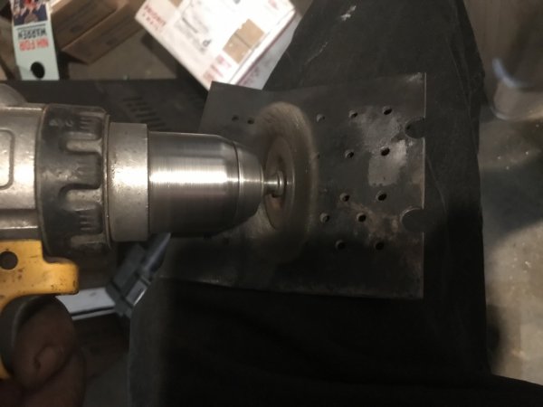

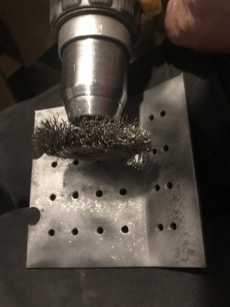

    What do you guys do?
    I got the wire wheel on the drill driver to get a layer of the black carbon off.
    Then put it in the Blasting Cabinet and blasted with white aluminum oxide.
    This cleaned it up well with a dull finish
    The last step I used the wire wheel again to give it a nice shiny polished finish!
    Pic 1 - Dirty wear plate
    Pic 2 - wire wheeling the first layer off
    Pic 3 & 4 - Blasting with the white aluminum oxide
    Pic 5 & 6 - made it shiny with the wire wheel
    Pic 7 - All done!
    See my blast media here

    Dry Moly is good but burn plate gets to hot for wax or anything

    once in a while if i am super bored i take it outside and hit it with the wire wheel on a pneumatic thing i forget the name but its like a dremel on steroids. cleans it up real nice. then it goes right back in the stove.

    Once a week I always take a wire wheel to my burnpot's after scraping the carbon off with a flat head screwdriver . Take it down to bare shiny metal and it functions beautifully after a good cleaning and wire wheel tune up . Apart of my weekly OCD cleaning .
