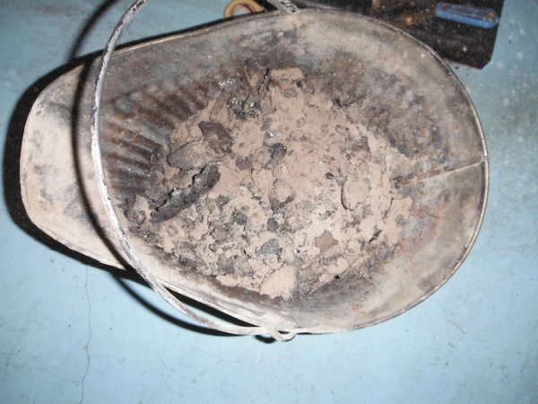

    Got about 3/4 of a coal bucket full of ash & hard brittle creosote. (mostly creosote)

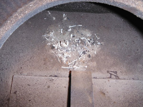

    Catalytic/bypass chamber. Found some bird bones & about 1/2" of fine ash
    look fairly recent, not covered with ash:

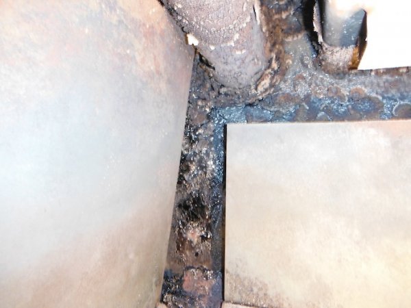

    top corners:

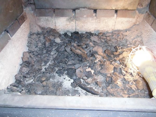

    After about an hour of scraping, pushing with a metal strap, wire , hands & putty knife.
    Most was between the shields & the stove walls.
    I had a good amount of creosote. (quite a bit in the vacuum too.)

    To some extent. It loosens up in the corners, and falls off easily, like it dries up some. The majority of it is behind shields on the sides and back, spaced in about an inch from the outer walls of the stove. There is also a bunch up top, especially around the tubes that take combustion air up to the 'airwash' :rolleyes:
    Nothing really burns until you scrape it off and dig it out from behind those shields. It will burn when it's in with the wood, but I've never been able to burn it clean. And I burned the stove HOT for weeks at a time last winter.
    The ignition temp of creosote is supposed to be around 1000°. Apparently that is only achieved at the top center of the stove, around the cat and bypass, and the inside of those shields that are directly exposed to flame.
