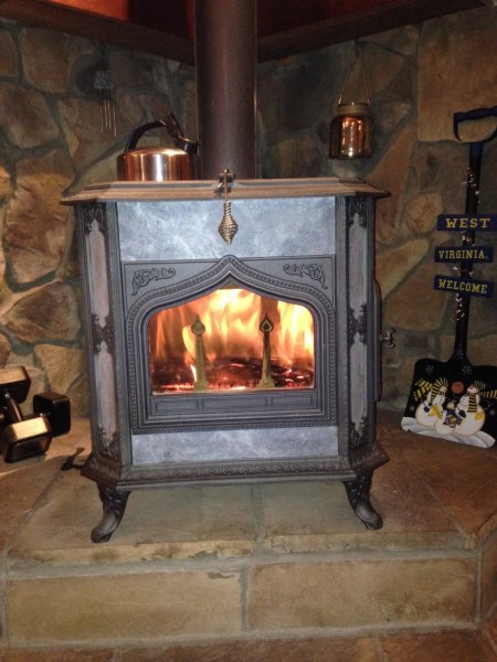

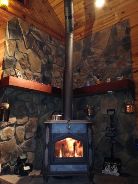

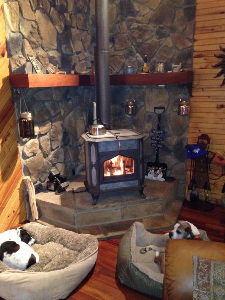

    No pics of the cleaning, was all fly ash in the newer stainless steel combuster from Woodstock-I knew stove wasnt cranking out when engaged---I also razor bladed the glass, polished the soapstone and man, is it cranking-I have windows open...Got into 50's today, after snowing yesterday in the 20's...It's snowing again now...Yo-Yo... IMG_5578.JPG IMG_5582.JPG IMG_5585.JPG

    Beautiful stove and love the stone background. Tile or natural stone?
    Heck, dog's get front row seating. You spoil yours more than I do mine. :)
    (She can get a bit whiney when I hop onto the computer to come to the site, I'm not paying attention to her. Oh the humanity.)

    No cats in this house brenndatomu - but seriously, I love all pets, they all deserve a home- Chaz, it's both-it has synthetic Eldorado stone and stone from my farm...they have this thing where you choose stone indigenous to your area. I have it elsewhere throughout my home-Some stone came from the creek on my farm and you cant tell the difference-Thank you to all for expressing condolences for my dear Savvy...We are hanging in there, I will not let her suffer...She ain't quittin yet...And Speck is so good to her, he's a linebacker in a kick returners body...Knows no fear!

    Nice looking setup !! :thumbs:
