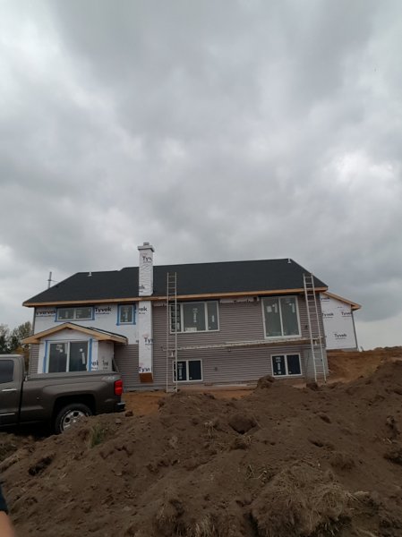

    I'm only 7" of pipe above it right now and then the cap. Draft is plenty good just want to get it up and away from the chase top to prevent some of the condensation/smoke stain drip off of it.

    Grab it, Sconnie. I wouldn't worry about 2-12" pieces as opposed to 1-24" section.
    Its on the outside of that shack anyway...:p
    It does look like you are conformed to termination requirements already though.
    Now about the streaks on your chase top....how long ago was your wood cut?
    Maybe a dark color chase top is easier? Gonna keep dripping down though...
