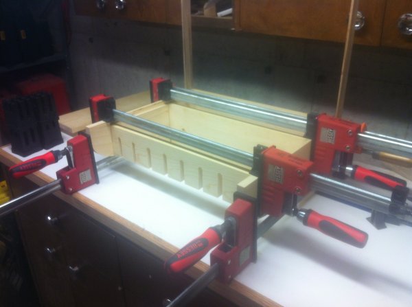

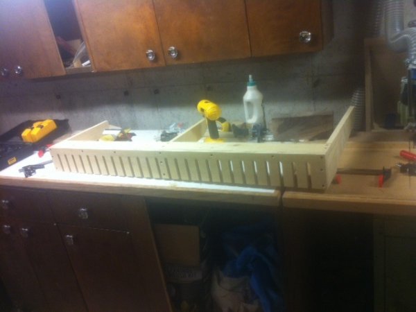

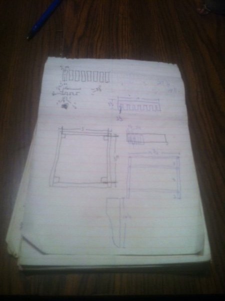

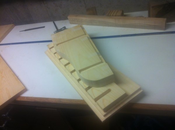

    Kind of sloppy out this weekend with so much melting snow - so i ended up working inside. I've been meaning to build some clamp racks for a while now.
    I used a couple Home Depot pine boards I had kicking around. They weren't very straight though. I tried to cope with it as best I could but the joinery suffered quite a bit. I plan to add a few trim pieces to hide some of the gaps.

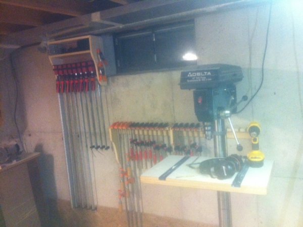

    I made a second one from a plywood remnant - much simpler design for this one. I tried to mimic the profile of the case sides for the support braces.
    The one with the shelf is hung from the floor joists on a custom cleat I made to get around the plumbing and ductwork. The other one is supported by some tabs that were left in the pre-fab concrete slabs in the basement walls.

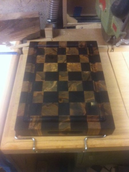

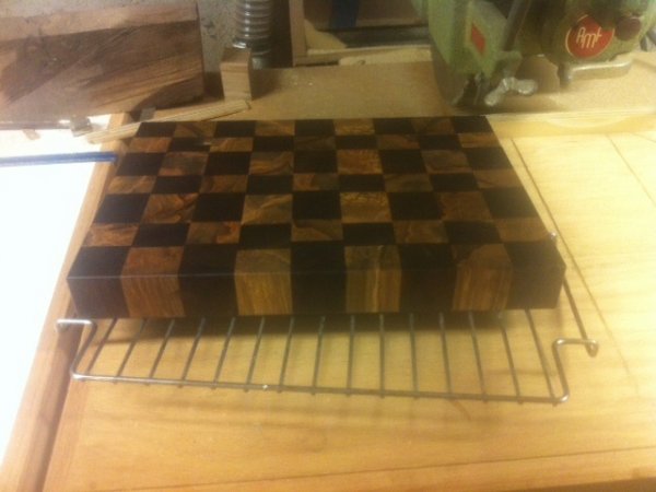

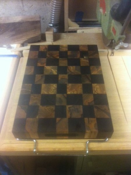

    I made another cutting board too - used the offcuts from the other ones I made. I used an end grain orientation this time. It was splintering out pretty bad at the ends while I was planing it, so I chamfered the corners off first and that took care of it.

    Hello. If you are interested in some 3-d cutting board plans, go to MTM woodworking on youtube. I have bought and built cutting boards off of his plans and they are spot on. you will have to use metric units of measure, my favourite, and follow the plans.

    Great work...they look awesome!
