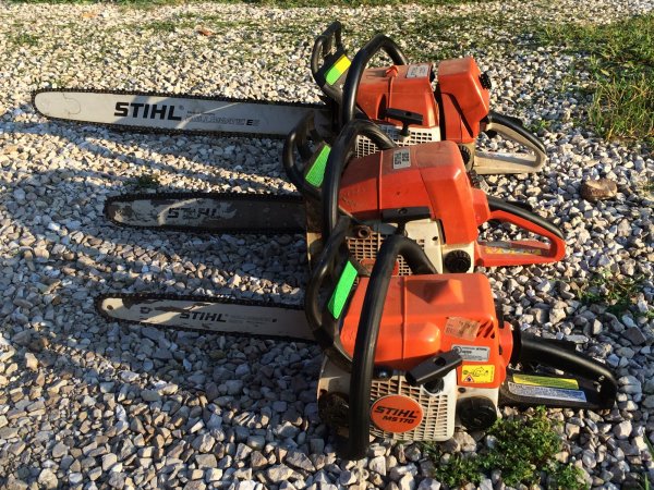

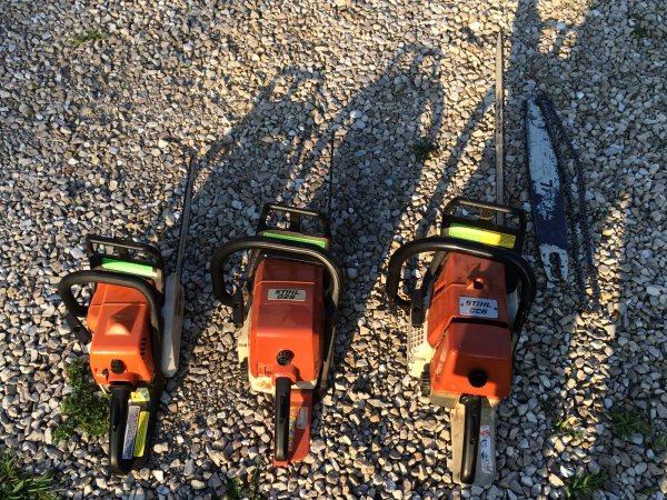

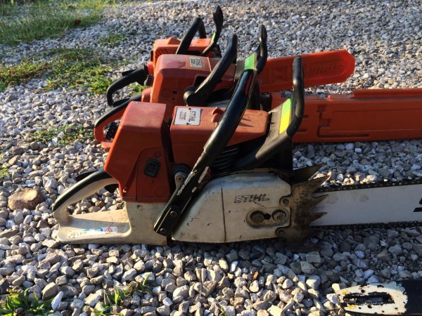

    Is that the 36" bar on your new 066?

    It looks like a 28", but that's the right bar for it if you ask me - the saw still has nice balance with that bar. 36" will be nose heavy, especially a full weight.
    Nice flat top Dave! :saw::saw: We need a pic of the grin when you get around to putting it in some wood! :D

    Looks like the 28" is laying on the ground beside it, in the last pic.

    I think that's the 20". Sorry, did not mean to sound like a know it all or imply the OP got "ripped off" or anything - the price difference between 28 and 36" ES is only $20.

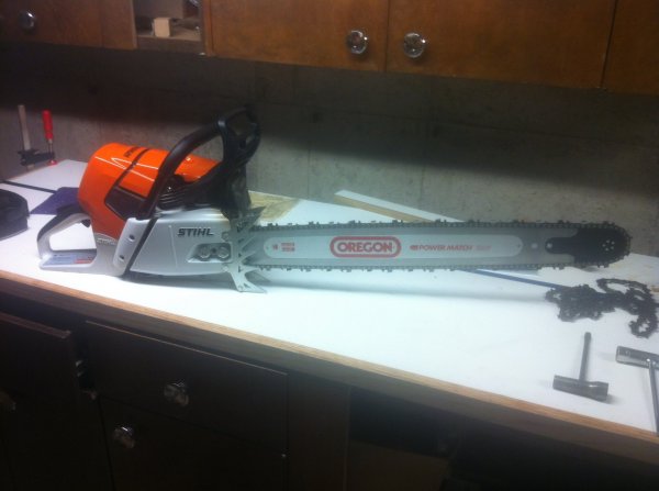

    First pic is 28", 2nd is 36". I sold the 36.

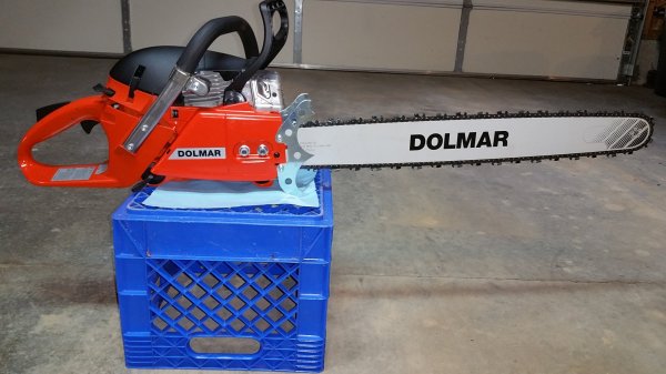

    Your right Shawn looks like a 28" to me, but maybe it's just the picture. Heres a 28" on my 7910.

    Yea that's not a 36" on it. It's probably the 20 and the 029 is wearing a 16"? The nose of the saw would be on the ground if it was a 36. My 650 with a 32" basically rests the tip on the ground as its nose heavy

    Pulled the cover I t's only a 30" bar not the 36" but that's fine with me I'll use a 30" more than a 36" Fired it up and did a test cut tonight, compression is
