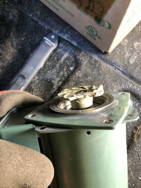

    Mine runs 24/7 during heating season. Started having some heating issues and decided to check the pump. Taco 007 lasted 9 years
