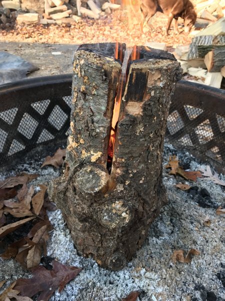

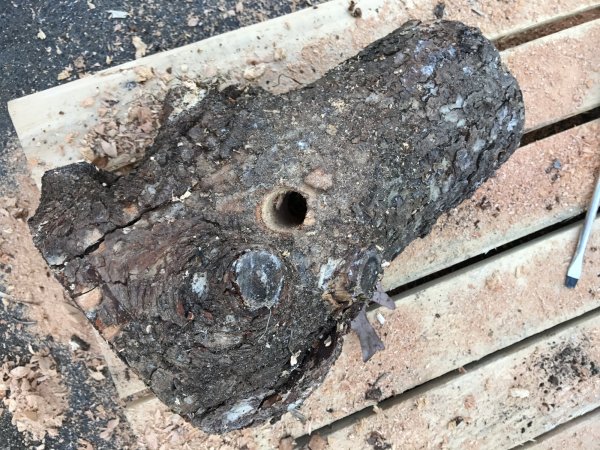

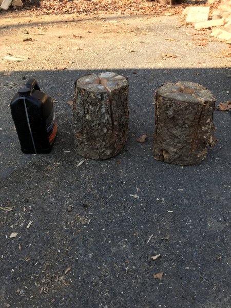

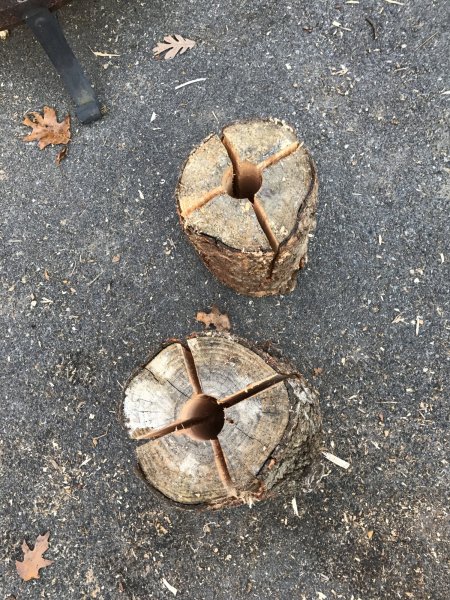

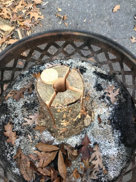

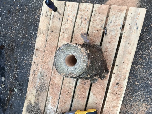

    This was my second trial, using super seasoned pine logs. 2 inch top hole, 1 inch air hole, plus sign type vertical cut, drop in lightning nugget fire starter, add a little splitter type scraps to taste, Swedish Torch. Best height I found is about bar oil jug size IMG_3567.JPG IMG_3568.JPG IMG_3570.JPG IMG_3575.JPG IMG_3578.JPG IMG_3580.JPG

    LOL, took me an hour to make 6! Note to self, when using 2 inch hole bit 12 inches inside a log, be sure you are bracing the log very tight, or else you have a lathe

    Do they last longer without the rocket stove vent holes ?

    If tried a couple without the vent holes, but they were harder to get going. BUt I was also using what I thought was very seasoned maple. So I'm going to stick with pine for now and the vent holes. I got about 90 minutes of nice fire from the pine one pictured with a pretty small log
    I now shoot for 12 inch diameter or so. JUst something to goof off with, and when I screw up, OWB doesn't mind

    For side vent holes I uses a regular style bit, 1 x 12 inch. For top hole I used a 2 inch forstner bit, but had to add an extension to it so I could get down 10-12 inches into log. At that depth with forstner, I had to go about 4 inches at a time, then pull it and all shavings out. Only takes a second, but found that if I didn't remove shavings about the 9 inch mark they would start to compress and bind. I used a 1/2 inch chuck, 9 amp dewalt two handle drill. Not sure it would be possible to hang on without two handles. I'm not sure I have it perfected yet, may mess around with hole dimensions some more, but works pretty good, and you can operate just like a camp stove by adding small branches etc once going. Very, very hot flame. Made a couple "deluxe" models where I took an 18 inch pine stump type piece and basically cut it into a cube 12 x 12. Will see how they go also. I do think I will hang onto my day job however. :)
