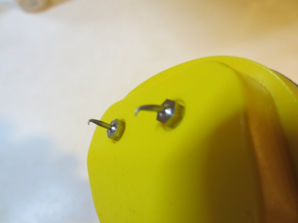

    I like to really jam them in there and i learned the hard way testing the MC of some dead black locust splits last year! :picard: Some dense stuff. IMG_2988.JPG

    Looks like those probes may need a prescription!!!!!!! :rofl: :lol::rofl: :lol::rofl: :lol:

    LOL!!! I bent them back with pliers and later ended up replacing them with the extra pair that came with it. Used it on myself and found i was very wet behind the ears! Reading was off the charts!
