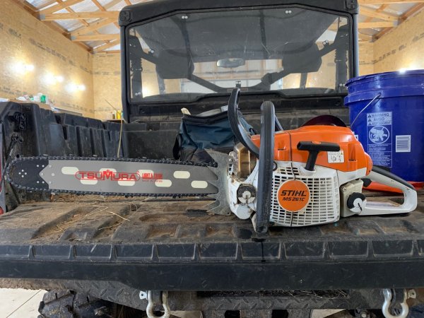

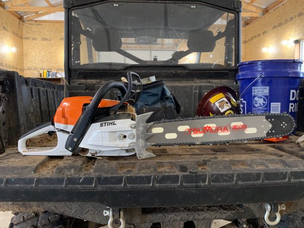

    Well, I decided to go to a regular .050 x 3/8 on my 261. I like sharpening the bigger chain better, and wanted to get away from the smaller chain, good or bad. I mounted a new Tsumura lightweight 20" bar and 7 point driver, and put a 3/8 x .050, full chisel, skip tooth chain on it. I like the skip tooth, and I like less teeth to sharpen. My 362 does alright with it, and I can't see how skip is any slower just because its' on a shorter bar.
    I took it out and cut some with it, and I think it cuts just fine. I don't know if it's slower or faster and I don't much care, it's fast enough for me regardless, since I am not into production cutting or in a big hurry to pile up a lot of wood at one time. And if I end up wanting to change back, it's easy and this new bar will fit my bigger saws if I want to use it on one of those. But for now, I am going to give it a good try, since I much prefer sharpening the bigger chain, and a lot less teeth compared to .325 full house chain.
    Stihl 261 C with Tsumura 20 inch lightweight bar.jpg Stihl 261 C with Tsumura 20 inch Lightweight, .050.jpg

    Cool. Did you have to put a different sprocket on the saw?

    Yes, I had to change to a 3/8" x 7 tooth sprocket. And I hadn't really compared sprocket sizes before. The 3/8" is a larger diameter, so in theory, I should have lost a little power there, but I think I probably gained chain speed and with skip tooth, maybe I am about even. I will have to cut more with it to really get a good feel for it, but it's hard to really notice a difference with it. Maybe if I had two identical saws to switch off on, I might detect some difference.

    Lastmohecken your 261 looks awesome with a Tsumura bar a bid dawgs! :bug:

    Thank you! The lightweight bar, is nice, even on a 20" bar with this saw weight.

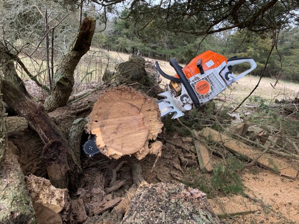

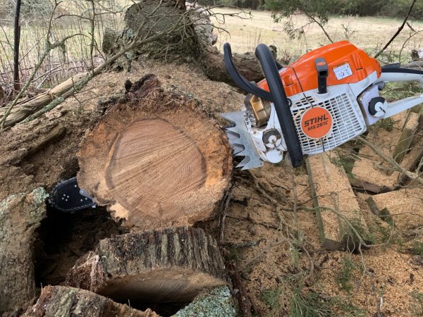

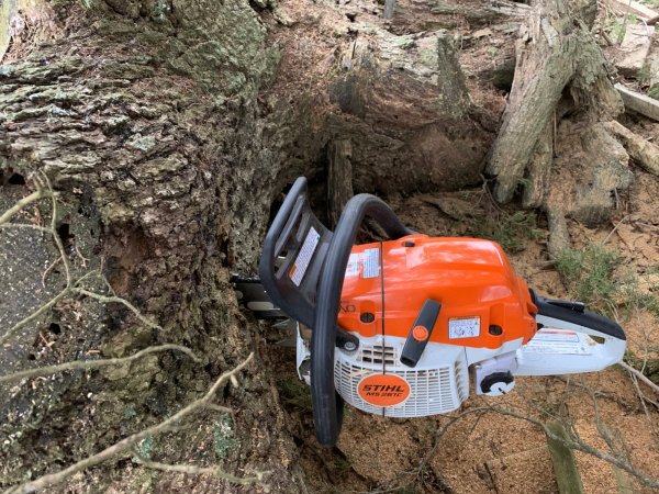

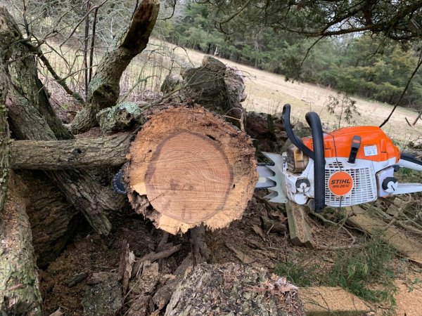

    I had a little time before dark, so I decided to go find out, on the bore cutting. I had this old Oak log from a tree that used to be in my yard, and it's solid in the middle but pretty soft on the outside, so not sure how good a test this is, but it seemed to do alright, but then again, I have not done a lot of bore cutting. In the last picture, I am buried up all of the way in wood.
    Stihl 261 bore cut into log.jpg Stihl 261 bore cut log.jpg Stihl 261 bore cut.jpg Stihl 261 bore cutting.jpg

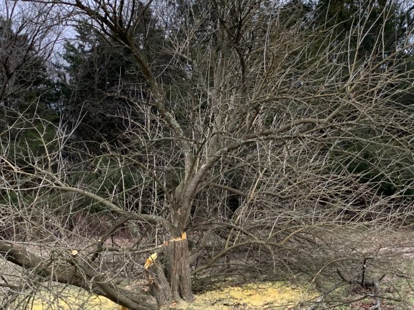

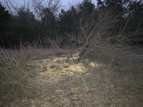

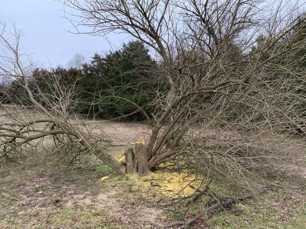

    I also decided to take down an Osage Orange tree, tonight, which I wanted out of my field. I am cutting up what wood there is out of it. I know Osage Orange is supposed to be good firewood, but I don't much like to cut it. The limbs have thorns and there are a lot of small limbs to deal with, for the wood you get. These trees are a pain to process. Usually, I prefer one of my saws with a longer bar for reach on stuff like this.
    However, the saw did good, but it got dark on me, so I didn't finish.
    Stihl 261 cutting some Osage Orange.jpg Stihl 261 cutting some Osage trees.jpg Stihl 261 cutting some Osage, got dark.jpg

    Saw looks good. Betting you’ll really like that bar after some use. I found these “boutique” bars aren’t just all show. They are better steel and require less rail dressing.

    I just looked at my first pictures, I posted and I only count 18 teeth visible, so my guess is there probably can't be more the 25 teeth total on that chain.
