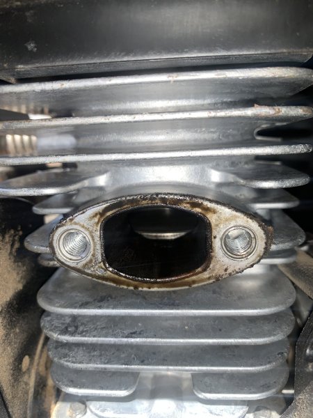

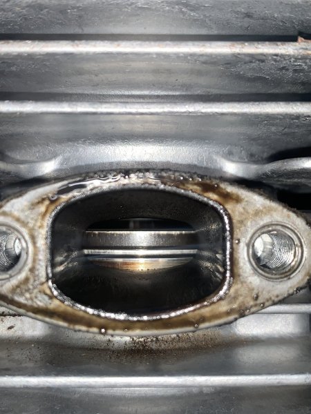

  6. The Wood Wolverine
    15,846
    97,772
    Sounds to me like your next step may be a new coil. Was the replacement fuel line and filter the same size as oem?
    Pulling the muffler is an easy thing to do, so start there, like mentioned above. Take a pic of the piston skirt and ring and share it with us. If your carb is not adjusted properly, the piston could be scored and causing your problems.

  8. Donnie Chainsaw
    Donnie Chainsaw
    Mar 22, 2021
    15
    64
    New Jersey
    I hope the pictures above help to determine if the piston is the issue. Any comments??

  9. The Wood Wolverine
    15,846
    97,772
    Doesn’t look too bad, so I’d count that out and say you aren’t tuning too lean or it would score.

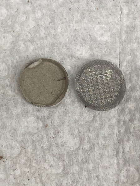

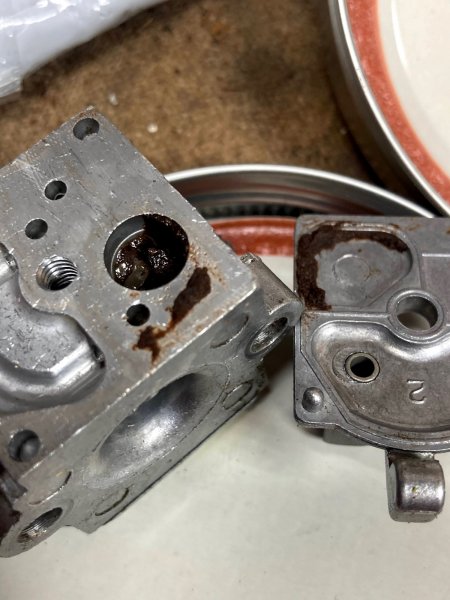

  19. M2theB
    M2theB
    Jan 13, 2017
    2,989
    19,074
    Central Massachusetts
    And I wouldn’t rule out you’ve sucked old fuel tank mud into the metering valve filter on the carb. That is a prime spot to loose fuel flow at full throttle.
    I’ve come across a few that acted that way and the screen was plugged. Surprised it could even idle.
    Here’s one from an 026, plastered vs new
    Here’s one from an 020 I rebuilt but neglected to rinse the tank before PMT
