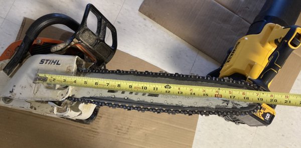

    New to the club and chainsaws, but using one regularly after a recent purchase. Trying to learn my way around them. I know this is novice question, but wasn't absolutely sure what size chain this Stihl takes. I thinks it 18", but didn't want to waste time ordering the wrong one. Stihl.jpg
    Anyone have any thoughts based on this picture?
    Appreciate any help and looking forward to learning more.

    I'm not a stihl guy but usually bars are measured from the front of the case. Looking at your tape i would guess you have a 16" bar.
    Maybe a stihl guy will come around and give you a more definitive answer.

    What model saw is that? Looks like an 028 (great saw btw) so should be .325 pitch, .063 gauge.
    74 drive links for an 18" bar.

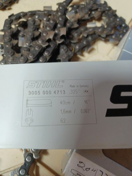

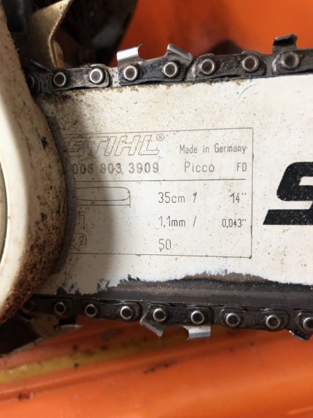

    These are the numbers on a stihl bar.
    .325 is the chain pitch.
    .063 is the thickness of the drive link that fits in the bar groove.
    16" is the bar length..
    62 is the number of drive links that determines chain length.
    This is just a pic of a stihl bar and NOT what you need for your saw.

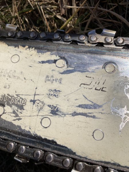

    Look on the bar for a stamp like this.
    3D994450-AA93-4517-8C8E-231676709F78.jpeg EA547D4A-D278-446B-AAFE-BABC3EF8E220.jpeg
    Then go to the store and get a chain with the same information .

    You're correct. This is a 028 and has been a great saw. This is great information. Thank you everyone for all your help! I came to the right place! I'll need to look this weekend, but now I know where to look.

    Chain size should be .325 pitch, .063 guage, 67 drive links for 16" bar, 74 drive links for 18" bar.

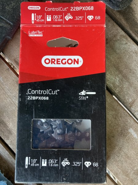

    After reading helpful responses was able to replace my chain with an Oregon chain. I didn't know what I was missing. I added an extra link because that's what they had. It feels like a new saw.
    Appreciate every ones help and comments.

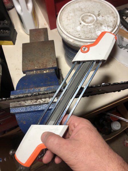

    The stihl 2-in-1 has been a wonderful tool to work with sharpening the chain.

    I have to agree with Farmer J.
    The Stihl 2n1 (made by Pferd) is an excellent way to learn to sharpen and maintain your chain getting there.
