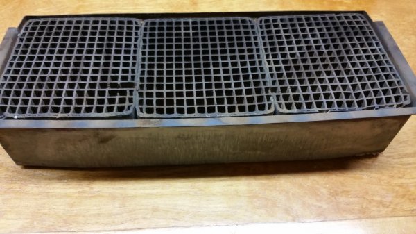

    Ive been having some serious issues with my BK Princess as of late, still running the original combustor from the spring of 2013. The symptoms were; terrible draft, low heat output, heavy wood consumption, and the worst part was the smell. We leave our bedroom window cracked at night, otherwise it would be to hot to sleep. The acrid smoke smell was waking me up at night, something had to be done.

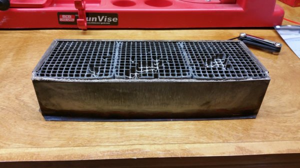

    I dont want to sling mud so ill leave the conversation with the BK VP for PMs. Long story short is i dont think im welcome at my local dealer anymore, but i have a replacement cat. (My wood is 15% avg. MC measured at about 70 degrees F) So i had time this weekend for a full sweep and clean and time to change out the cat(Which i was told couldnt be bad allready unless i abused my stove.....). While on the roof i had a real shock. More creosote than i have seen in my last 10 years of burning. It looked like hardened lava, bubbly and all. Felt good to get it all off of there. Shop vac-ed all the crud out and popped out the cat, not as easy to remove as i thought. It was REALLY in there.

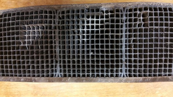

    Once it was out i found that the refractory had cracks all through it and that there were some places with missing refractory on the back side. Got the new one in and had a few small fires, first real fire was today. damm, this is awesome again. Half the wood and twice the heat. In BK's defense i might have not been completely aware of how not to operate the stove our first year, but the warranty (10Yr) says nothing about neglect. But in my defense i found this When to Replace Your Catalytic Combustor - Woodstove Combustors by Condar I suggest anyone with a newer cat stove be aware of the zone theyre in, it hit my cat dead on the head.
    Pics of the cat - front
    Rear- note the precious metals flaking off and creating obstructions, also the huge areas of missing refractory....

    Is the new one also ceramic? The cat is 2" thick so I wouldn't say that the spalling was huge. My oem ceramic lasted about as long, three years of 24/7 burning for 9 months per year. Flakey on the back too.
    I'm on metal now.
