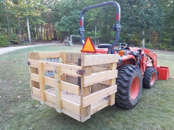

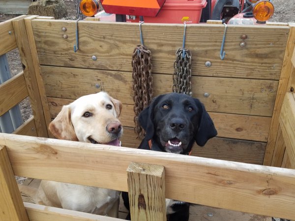

    I really enjoy seeing the different purpose-built rigs of the many members that have built carryalls.
    So, I figured why not see if we can put a thread together with a bunch of different photos. Tractor color doesn't matter. :tractor:
    Would you folks be so kind as to share what you've built?

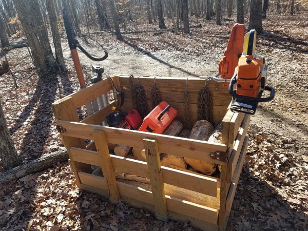

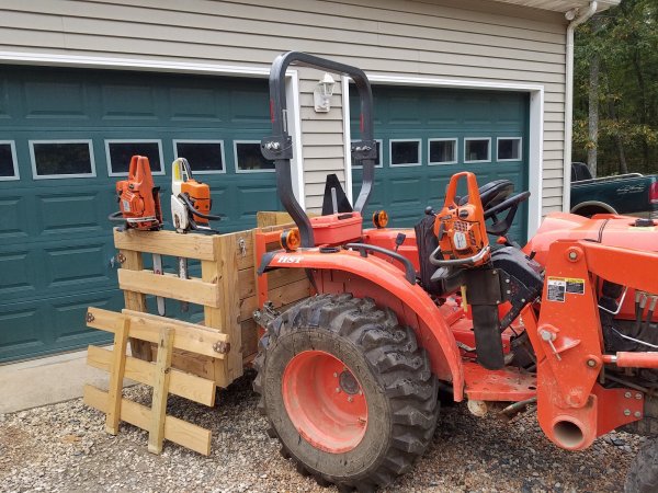

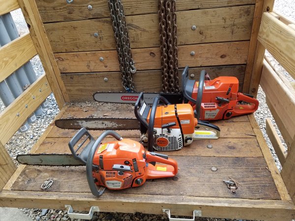

    Here are some pix of my carryall. I think I am on version 3-ish. :thumbs: And, of course, some pix of pups and saws! :D
    Enjoy!

    I like your setup! I am not seeing the 3 point connection. Are you using pallet forks, or did you build it to hook up direct?

    Kan wee C the tractor side of it? What I mean is how it attaches to the 3 point hitch?
    I really like the look of it.:)

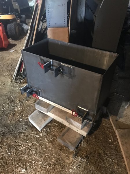

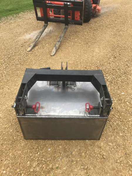

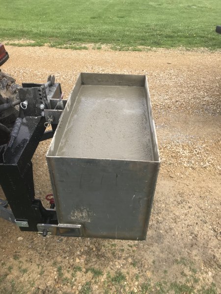

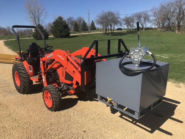

    Only things I have built tractor related. Ballast box is all 1/4” and filled with concrete. It does fit my ms260 16” bar, fuel, and a jug of bar oil and is contained by the steel lip. A6428F39-716C-4B47-8A25-9382B7F86844.jpeg 129BEBF7-0A9D-4944-A6A9-54DC6111B764.jpeg 98627B6B-C5C2-4B78-9F84-6CFF78DB8B98.jpeg 54911187-2790-407D-BEB5-738D47DFAFE7.jpeg B7992E76-0222-49C8-9D79-AB93367154A8.jpeg The diesel tank holds about 70 gallons.

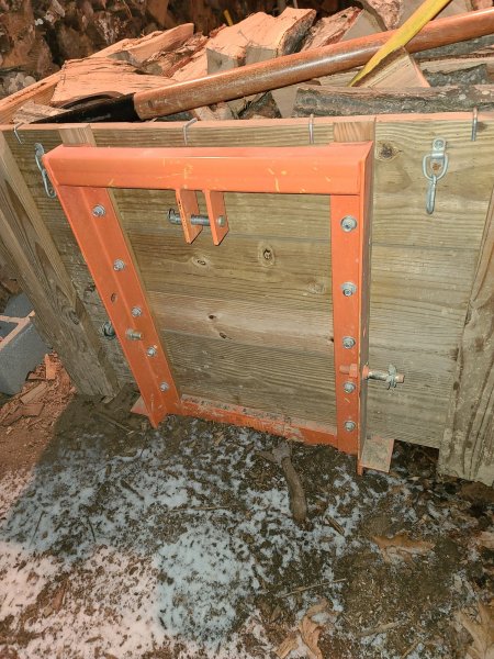

    It is a normal carryall frame that hooks to the 3 point. I purchased the frame at the local Southern States and painted it orange. Here is a pic of the hook up side. It is just a normal Cat1 set up.
    For what it is worth, I use a set of the Pat's on my Kubota. Pats Category 1 Premium 3 Point Quick Change Hitch with Bar - 102ST

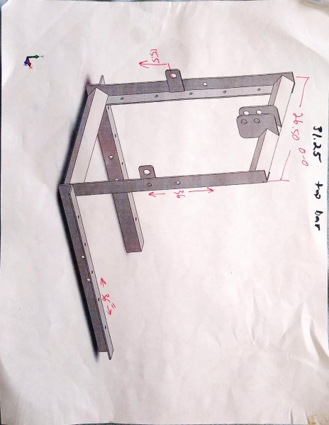

    I don't have one yet. My son wants to learn how to weld. So I drew up some plans and picked up some steel from the scrapyard. It just lacks cutting, grinding, welding, and finishing up.:D I have made the pin mounts using a water jet.
    If I can find the right receiver hitch at the scrapyard I'll add on to the open end to tow a splitter or smaller trailer.
