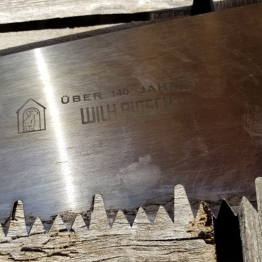

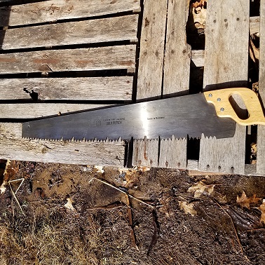

    Not the best pictures, but this is the saw that needs sharpening. My apologies about earlier comments regarding uploading photos. They were too large after all.

    That saw does not look like it has been used much. Take your files and just touch up the teeth a little. If you don't take much you may get by without putting more set in it.
