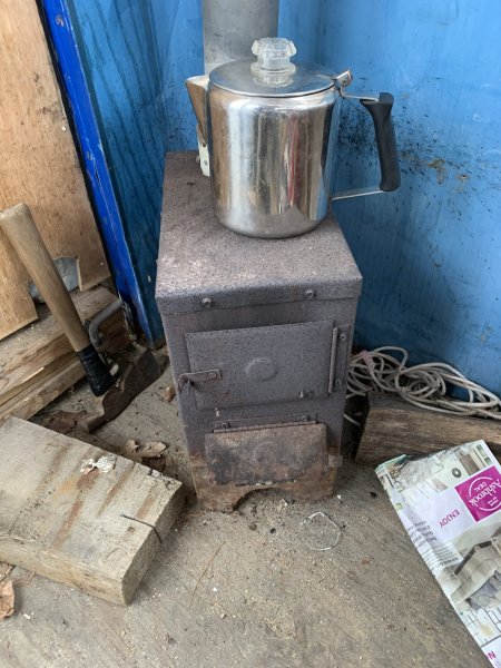

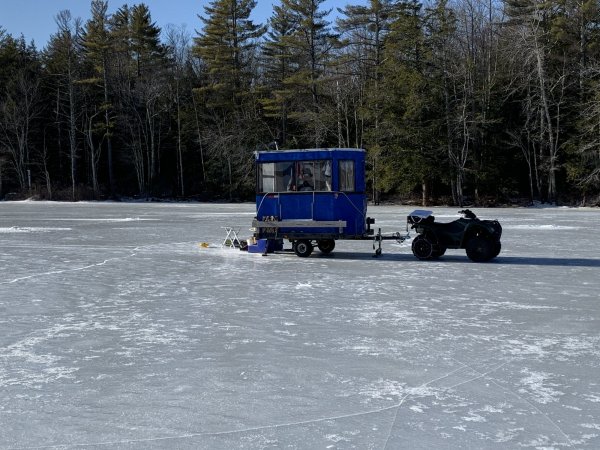

    I’ll start by saying if someone were to do that the need to understand that some see it as risky.
    we use a mall camp stove to heat the fishing shanty it works quite well. 52E65BD4-39D6-4885-BA1F-9C85E5C1BD04.jpeg However you need to constantly load it. I would imagine it would take quite a while to get any actual heat in a cold garage. And it’s a bit of a pia to process wood small enough to get in the stove.
    Can it be done sure, is it practical I doubt it.
