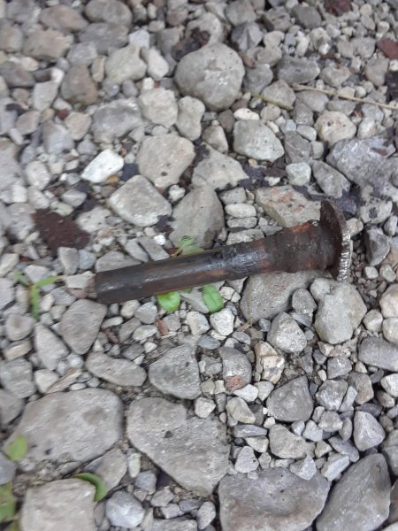

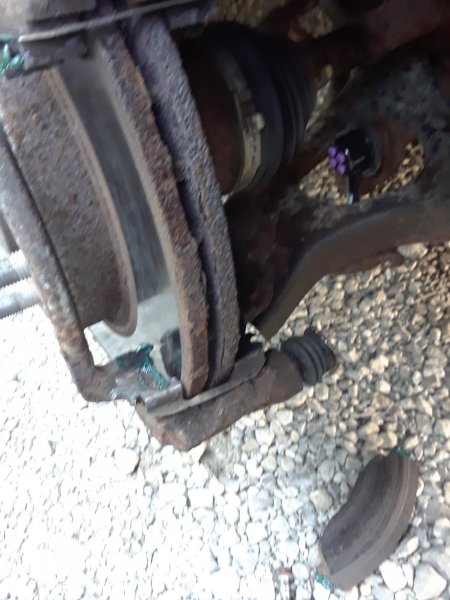

    I have a Honda civic, maybe 2009? 130k. A FedEx truck backed into a rural highway and I had to slam on my breaks at 55 mph. The front right break locked up. I got it home, opened up the breaks and they look ok. Greased up the contact points but, the bottom slide pin on the caliper is stuck. I am not sure if the rubber is stuck in there or what. I hit it with a mallet and screw driver, worked on it with some vise grips, wd-40... still stuck. Any ideas to loosen this up?

    Lol. No wonder it was stuck. The torch worked great.

    So I am stuck with a rusty caliper pin. I will hit up the parts store in the morning. You think I need a new caliper or will a new pin do the job?

    someone didn't lube the slide pins with caliper grease as required when doing the last brake job.
  7. brenndatomu
    20,555
    128,083
    A bench grinder with a wire wheel will clean that right up...if you have one, or access to one....just make sure the boot/seal is still good...and grease it up good this time.

    brakes are nothing to fool with. with todays pricing I would replace it all.
    RockAuto 200 bucks
    rotors, calipers, slides and pads
    you know the other side is as bad or worse.

    Yeah. And that was 2 years ago, maybe 6k miles. Not happy with my (former) shop right now.

    Yeah, boot is toast. I have the tools though. I will see what they have to repair or replace at my local parts shop. I need some break cleaner anyhow.

    For anybody in the future, be careful where the slide pin is pointed if you heat up the bracket to get it out. I have seen the grease boil and build up enough pressure to shoot the pin out like a rocket. Dude lost part of his hand. It is an effective way to get the pin out.

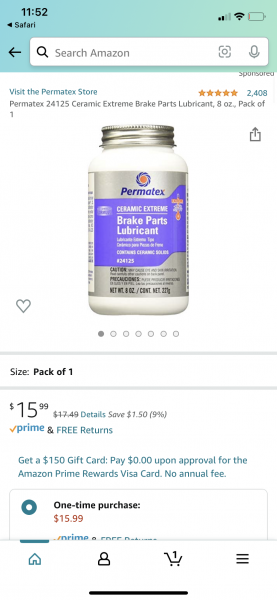

    Is there a high temperature silicon? I saw someone talking about a synthetic lubricant on a Honda forum.
