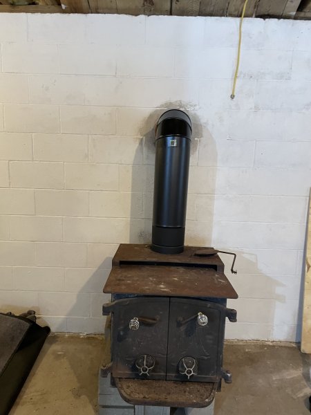

    Thanks for the info. Unfortunately, it looks like I am retiring the fisher. Had the chimney inspected again this year. I still waiting on the report. But the sweep told me I have stage 3 creosote build up. He also said that the mortar in my terra cotta chimney is failing and that it is a hazard. I’m not so worried about me, but so have my little girls and wife in the house. I’m gonna see if I can get a SS liner down the flu, and get a newer stove….
    Odd thing about the creosote is that I maybe used the stove 6 weekends last winter, which is not a lot considering people here burn 8 months straight. Can that much creosote build up that badly with such limited use? Should I get a second opinion? OP, sorry If it seems I am hijacking the thread.

    The Insert was being used without a liner directly connected to it, all the way to the top??
    A full liner is required with ANY Insert.
    Yes, it can form rapidly depending on the diameter of the fireplace chimney flue. As I mentioned above, flue gas must satay above 250*f when smoke is present. When allowed to expand into a larger area of a larger flue made for a open fireplace, temperature drops drastically. Hence the reason for the liner code being the same size as appliance outlet.

    Coaly I used it as a free standing stove. Stove pipe going into a thimble. Terracotta liner all the way up. You actually give me some guidance on the set up. D228C1B0-B75C-4773-B40B-1C4B25BD32B5.jpeg

    Ok, normally an Insert is using a chimney made for an open fireplace that has a larger flue. That’s fine.
    Perhaps the stage 3 hard coating has been there and not removed the last time it was cleaned? If the joints are leaking bad, the cold air mixing with flue gases will lower the flue temp allowing water vapor to condense on flue walls.

    Understood, I had a BK insert installed in the fireplace on the main floor, so I am familiar with that. I don’t know that the flu in question was ever used much. When I get the new inspection report, would you mind if I pM you? I do not want to clog up the OPS thread with my issues. I am also going to get a second opinion from another company. Last year, the guy couldn’t legally tell me it was ok to use for liability purposes, but definitely alluded to the fact it was ok.
    This new tech was a hard “NO” when asked. I am also questioning his knowledge a bit because I was asking about a block off plate for the insert upstairs, and he had no clue what I was talking about. I don’t want to give up the stove if I don’t have to, but It’s not even a question if it puts the family at a risk.
