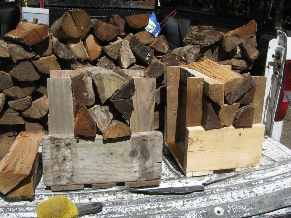

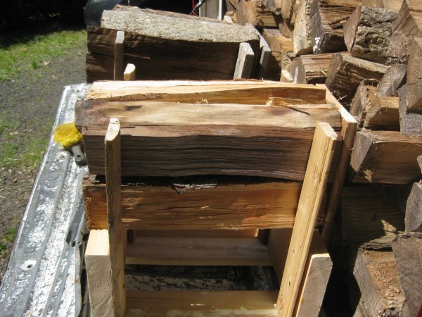

Bundle delivery i made yesterday. .60 cubic ft. 8x8x16" Mix of sugar maple, black birch, cherry, black walnut and TOH. Some soft maple in the mix too. Warmer weather has me using more weathered splits than in the cold. I figure they are used outdoors. My simple jigs full and ready for wrapping. Have another order going this week.

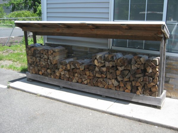

Most of my bundles sales are mid-April through Thanksgiving. Knowing that it's getting burned for looks and not heat, I don't use the high end wood. Right now it's all silver maple, cottonwood and ash. Straight as an arrow, splits great, dries fast. My "bundle grade" is the straight splits, mostly without bark. It stacks very neatly in the bundler and is easy to wrap. And presents nicely (and very clean) in my stand. Light enough that anybody can pick the bundle up and carry it to the backyard.
