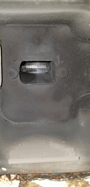

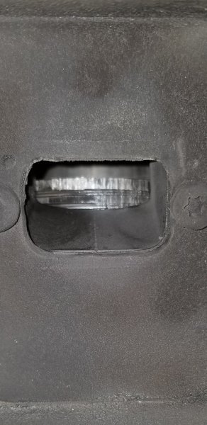

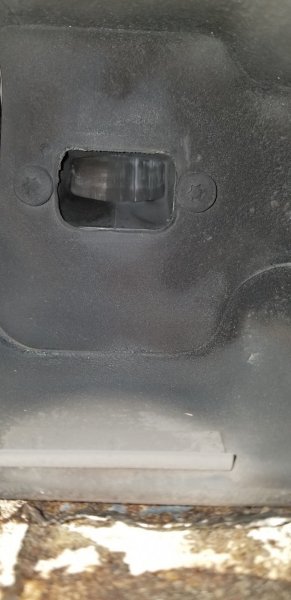

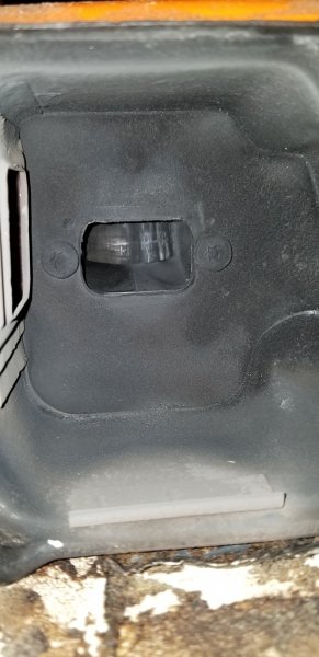

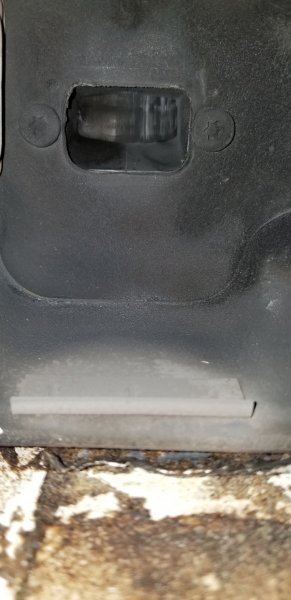

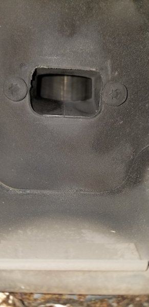

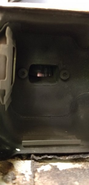

    This, can't be good. Had the 32" bar with new chain on it. As far as I got on it today. Any ideas?

    Well bummer is right , I can't "Like" them pics :(
    Looks like it got leaned out .

    Yeah looks lean for sure, been sitting a while?
    Not straight gassed I assume?
    That the Stihl?

    Yep, 660. Gas was in it awhile, not sure how long, but I've never had a problem before and always run e-free premium about 40 to 1. Need to decide if I should get another big bore for it, not sure the brand on it now, or aftermarket. OEM is a little high for me. Not set up to pressure test it.

    Looks like it scored right across the rings. That is a shame.
    The Meteor pistons for the 066 Stihls I think are pretty good. I have one I installed in one of my saws and have been milling with it and so far it has held up real well.
    I would also try and save the cylinder. A lot of the time it is just aluminum transfer and can be removed.
