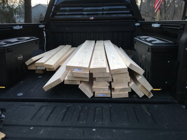

    Wood acquired! Total lumber bill was about $140

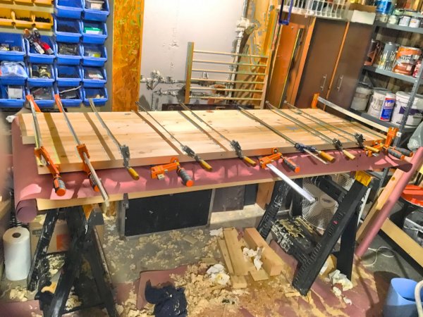

    Laminating one of the bench tops

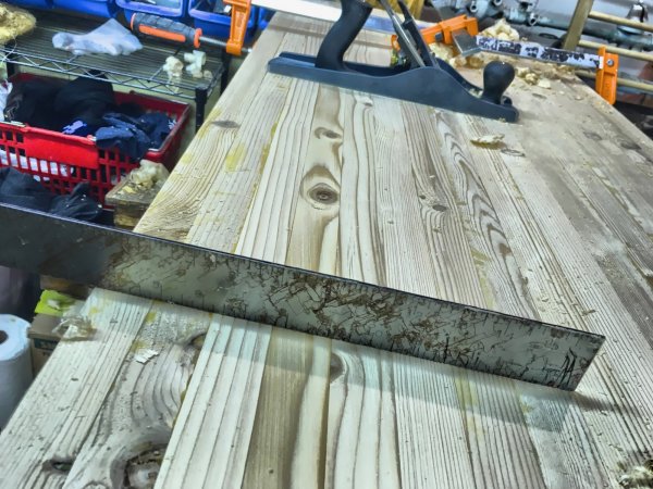

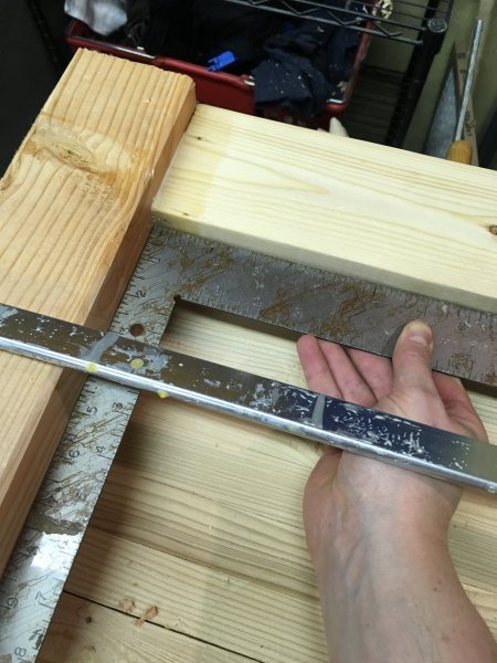

    Getting things squared up, and learning how to adjust and use a hand plane.

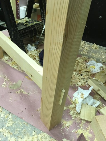

    First mortises cut with a hammer and chisel

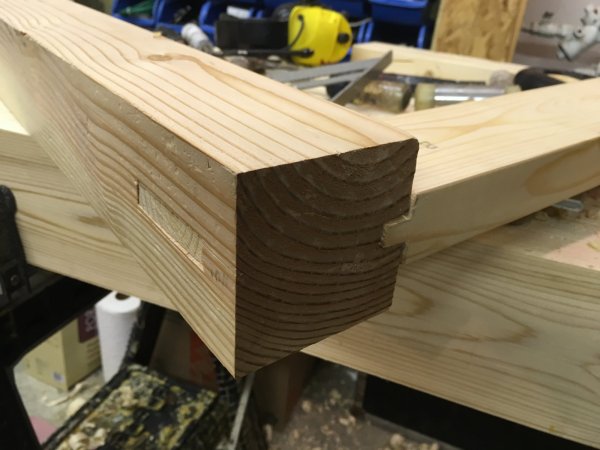

    First tenon fitted. A "haunched tenon". I need to tweak the fit a bit to get it more flush, but overall a good start. Only 3 more of these and 4 more regular tenons to go!

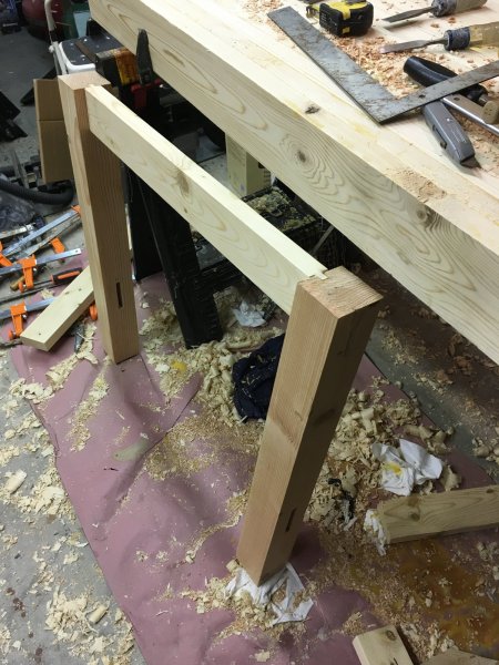

    IMG_7598.JPG Today's lesson: I really need a mortise gauge and a gents saw. But, progress was made!

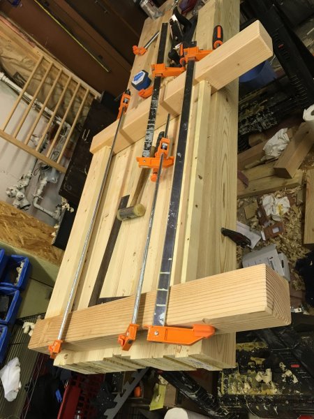

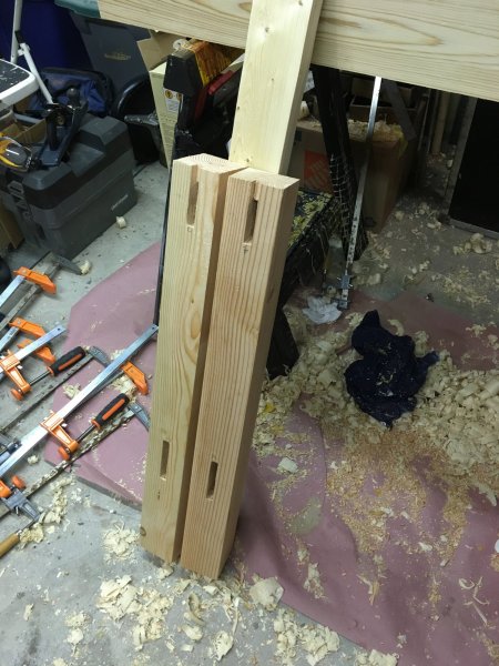

    IMG_7613.JPG Not a ton of progress today. But I did get the glue up done for the aprons. Tomorrow it is back to hacking mortises for the 2nd set of legs.

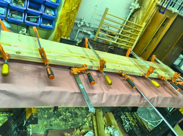

    I wanted a bench that would work well for hand crafting which means lots of chisel work. Wanted a lot of mass, tool well, and two vises. This design had a lumber bill of about $150, and It had enough complexity to learn a few things. After the initial planing, everything has been done by havd with saws and chisels.
    Got the final lamination done today fwiw! This is the base pf the tool well.

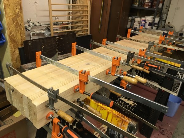

    IMG_7628.JPG IMG_7627.JPG Cut the rest of the leg parts and got 1st legs glued up!
