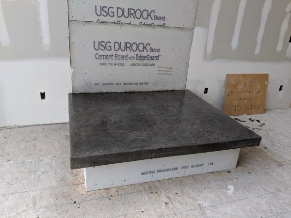

  16. Lakeside
    Lakeside
    Feb 22, 2019
    36
    306
    New Richmond, WI
    IMG_20190616_140324.jpg We are in the process of building a house that size right now. I purchased a wood stock progress hybrid but it hadn't arrived quite yet. I did get the hearth mostly built with 4 inches of stamped and stained concrete on top as seen below. I still have to do the rock work along the edges and the wall. Looking forward to the winter.
  17. Highbeam
    Highbeam
    Jun 25, 2014
    1,763
    5,477
    I have no doubt that many people are willing to live with this limitation. It’s easy to miss though and could be a big problem if you did miss it.
