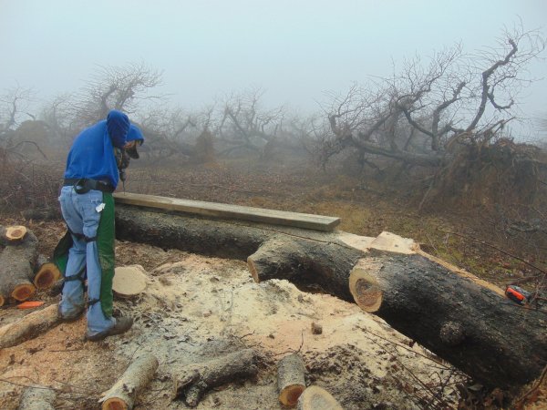

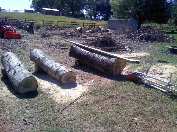

    Milling sure can become an addictive hobby. It's a lot of work and literally stinks. A leaf blower or fan of some sorts really helps redirect fumes. I've milled a bunch at 40/1 and have tore the saw down multiple times to keep an eye on wear. So far so good.
    60cc is doable and it sounds as though you have the right pregame plan. Where your wood sits, what is sits on and proper top weighting is very important. Your beams twist and bow and you end up with wasted time. Don't skimp on the sticker stacking.

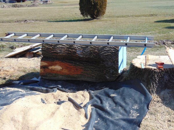

    Another rookie mistake is to not have your first cut depth below screw length. I've skimmed screws twice. It sucks period. Be vigilant in making sure you clear 'em. I've used an old aluminum ladder and length of 2x6 as a first cut guide. If you can get the log on a downhill slope, it will ease the amount of pressure needed to make the cuts.
