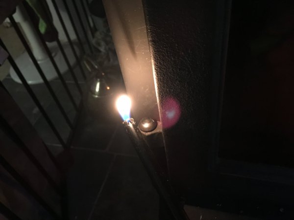

    I had a runaway fire. With normal splits. Writing to manufacturing company they directed me to the manual of course. I was also given a video to which the stove was loaded up to the top. Splits facing north south as I had done. Upon inspection: nothing out of the ordinary. Until I checked the gasket with a dollar bill. It slid through the top and bottom with far too much ease. Having adjusted the tension on the door lock, a small part of top part of the door gasket is tight but bottom and sides it slides out the same way.
    At this point I’m noticing that too much air is getting into the stove. Question is:
    Do what now???!

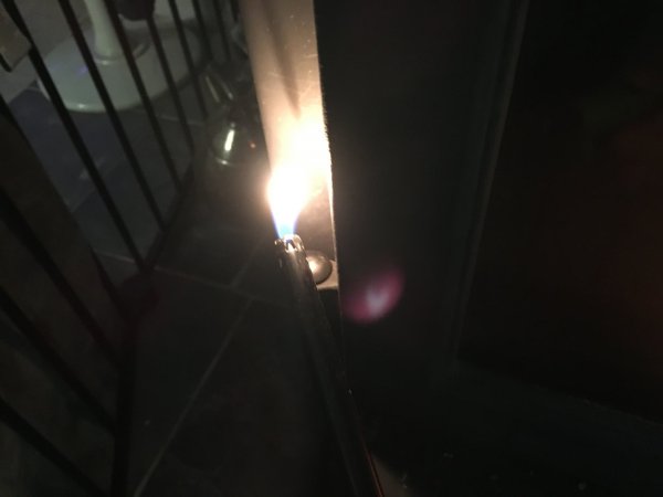

    I just double checked this by doing this. 8484ADA9-80A0-4DE8-B3E5-3A6E31D8C2B8.jpeg A2D8FD7E-C986-4018-8BD6-5A4841E8C34F.jpeg
    A pull on the door hinge side. I’m not going to load my stove up much past this point until I get a new gasket on here.

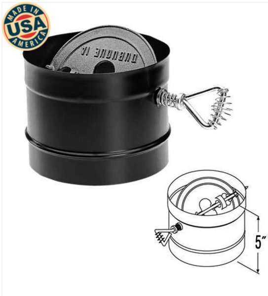

    Need?, probably not but I find that it helps.. The door latch on my Buck 81 gets loose every now and then not allowing me to completely close the door. Prior to a damper, I found I had less control over the stove (kind of like a leaky door gasket) than I had when I could close the door tight. It was a progressive problem that would appear slowly until I grabbed a Phillips head screwdriver to tighten the latch. I, and several others here have found that even though the manufacturers and dealers say you don’t need a pipe damper, it helps to control the fire and helps reduce fuel consumption. There’s a big difference in draft that I would get on a 40 degree day vs a -10 day... Trying to control that draft with primary air alone can be a challenge. For me it was an easy $20 to spend and 20 minutes investment in time to install... YMMV..

    I might be surprised at this, just figuring how to install...either with a piece of pipe like you have shown me there or its just the damper itself.

    You can get just the damper or the damper installed in a short section of stove pipe. Which is easier to install will depend on your setup.
    With the one in the pipe section, you just insert it into the chain, but to make room, if you don’t have an adjustable section with enough play you may need to cut 6” off one of your pipes.
    If you get just the damper, you drill a hole through both sides of a pipe section for the handle/axel. The damper gets held in place inside the pipe with one hand and you push the handle in from the outside through the damper and out the other and then secure the hardware.
    You have to decide if it is easier to drill the holes, cut a pipe, or if you are lucky, neither.
