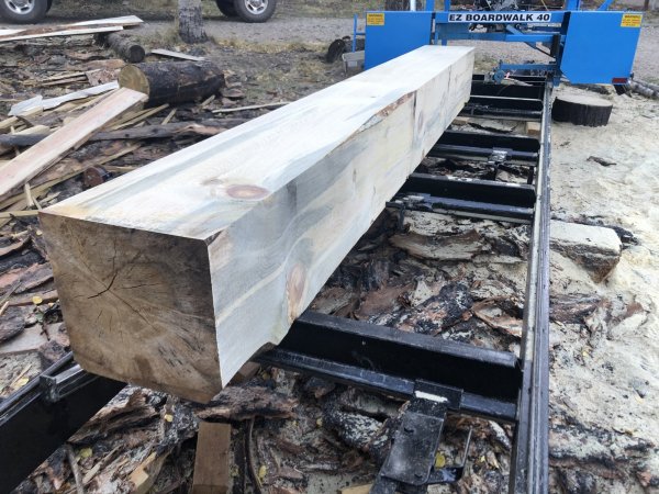

    I have been cutting boards for my shop a variety of widths but now have some really big logs to work up with my bandsaw. The cant I have ready to start slicing up is 14”x14”. Think I can get away with 14” wide boards or is that too wide?
    The wood is ponderosa pine.

    The only problem I see is the varying widths. With batons, that would really catch my eye, and to me, look like a mistake.
    On the other hand, sawing a 14" board in half would bother me too.:headbang:

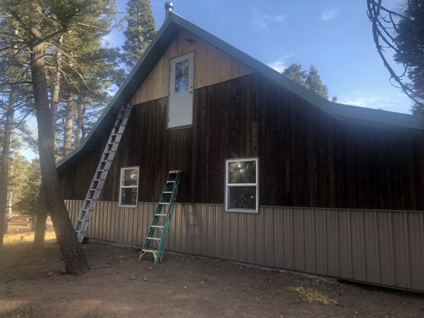

    I did one of my barns with a ship lap and purposely alternated 10” and 12”. I agree with fuelrod that battens would make the differences very obvious, and likely not in a good way.

    Without battens. Letting it cure.

    I have almost enough boards cut to finish the job stacked, stickered, and drying. We got dumped on Sunday night with 30 to 36 inches of snow so my board making and board installation has been put on hold. It doesn't take them very long to get manageable/dry being the logs were 2 years old and went thru a hot forest fire.
    If it doesn't warm up enough to melt some of this I may be waiting until spring to finish up. Thanks for the post.
