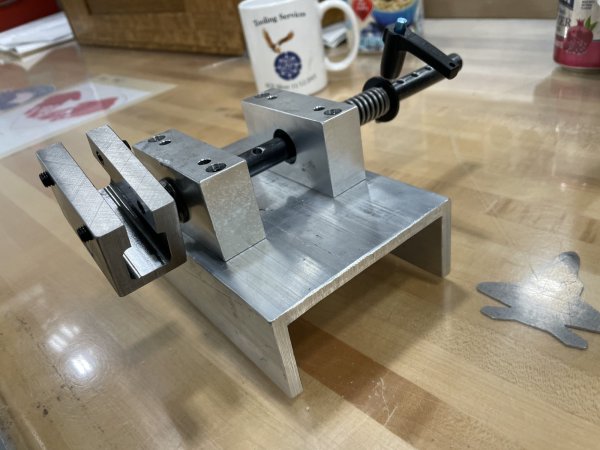

    With lumber prices being how they are, I’ve been wondering about making my own lumber (like many people I’m sure) I want to buy (make?) an Alaska mill at some point to do slabs but to start out I wanted something really simple just to get a feel for things. I want to build a crude wood shed/pole barn structure, and figured one of these would work for 2-siding logs, making posts and beams. Rather than buying a $50 one and giving Amazon/China the business I decided to make my own. Don’t mind the crude machining (I made it a little at a time on breaks at work). Non functional surfaces I left saw cut. If this works I can make a better one down the road. So basically I started with a 4x4 square extruded aluminum tube and made it into a channel (3.5” spread inside to ride on a 2x4). Added a couple aluminum blocks, cap screwed and doweled on location with hardened steel bushings for the pivoting rod. Welded a bar clamping block to the pivoting rod, machined the block out with clearance and added set screws that’ll clamp onto my chainsaw bar. I wanted adjustment outwards to accommodate different sized logs so I added 5 sets of holes, in 1/2” increments. There’s a dowel pin with a light press fit that rides against the outer face of the bushing behind the bar block. Opposite side has a spring to keep it under tension, a washer and a ball lock pin. Remove the ball lock pin, move the dowel on the opposite side, move the ball lock pin accordingly and that’s how I set my adjustment for bar positioning. I may have to add a mount and some weight, to keep the whole Mickey Mouse rig cutting consistently. We’ll see. C513FDF4-EF16-47BF-9CC6-728A1A3A76F9.jpeg

    Don't cut yourself short on that machine work either , It looks a lot better than some things I have seen.
    You are not new at it , that is very obvious.

    Looks like a extremely upgraded version of a Haddon lumber maker nice work JB

    The one feature I should have borrowed from the Haddon design is the adjustable base. Having the ability to use a 2x4 or 2x6 etc. is a nice option. If this one works out then the next one I make will have it for sure.

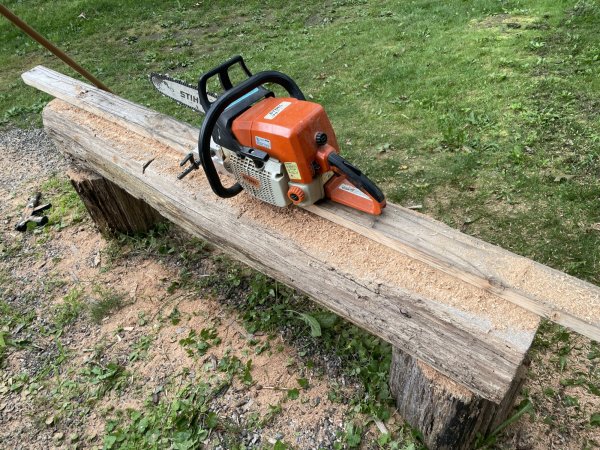

    3DA30E8B-1DC0-41FE-A12B-73FAD059D807.jpeg The verdict is this thing is going to sit until there’s a global collapse and I need it as a matter of survival. Maybe if it wasn’t a bajillion degrees outside with 1000% humidity I’d keep going but I’m done for now. Of course it doesn’t help that this is red oak and not some soft conifer... If I ever feel motivated to use it again and have success I’ll share about it. Oh, it DOES work! I just don’t feel like working that hard right now :) 2 and a half sides roughed in and I’m out of steam.

    ...at least it was cloudy! :whistle: Looks good though!
  16. Eric Wanderweg
    6,308
    47,786
    I just noticed I hit a nail on the second side. No wonder I started struggling. Chips coming off looked decent enough but the chain was dull. It doesn’t take much, as you know. :headbang:

    You running that homemade mill with an 029...
    Maybe go a little bigger if you can get your mitts on something for a decent price? Ported would be even slicker...
    I know those things might be cost prohibitive, just sayin’.....

    Good call :handshake: I know it’s asking a lot of this saw as it is. As luck would have it, I’ll be sending it to Huskihl later this week so he can do his thing. Eventually I’ll be in the market for larger bore saw and then I can really get down to business with this mill.

    No it doesnt and thats aggravating for sure. Have you hit metal before?

    I may be willing to part with one of my bigger saws in the future...036 or 460. All depends on how big you will be milling. I know huskihl did T.Jeff Veal's 029.
