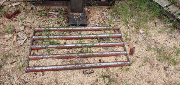

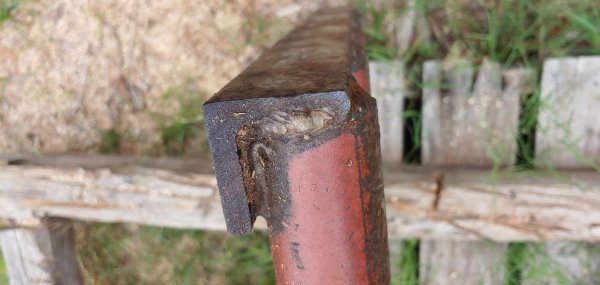

    It is made with 1 1/2" handrail pipe and 2x2x5/16 angle iron, I think...
    Just measure the thickness of your splitter foot plus the tabs, make it a bit higher than that. 0607201154.jpg 0607201155a.jpg

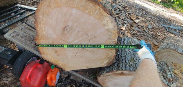

    We have split some big rounds on it, 46" is the largest so far.

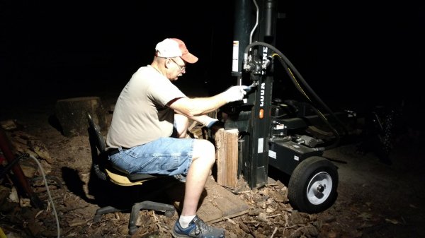

    True, that is the way we handle big rounds when we have a lot of them. I can kneel down, but that hurts my knees more.
    When we used to split vertical all the time, we used a chair. IMG_20180920_201629817.jpg

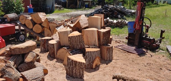

    And we have handled some big rounds. These averaged about 975# each... FB_IMG_1549200590540.jpg
    Anything up to 28-30" dia we roll up the ramps. 0925210949a.jpg 0925211205_HDR.jpg
