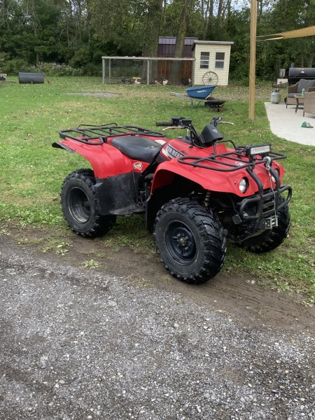

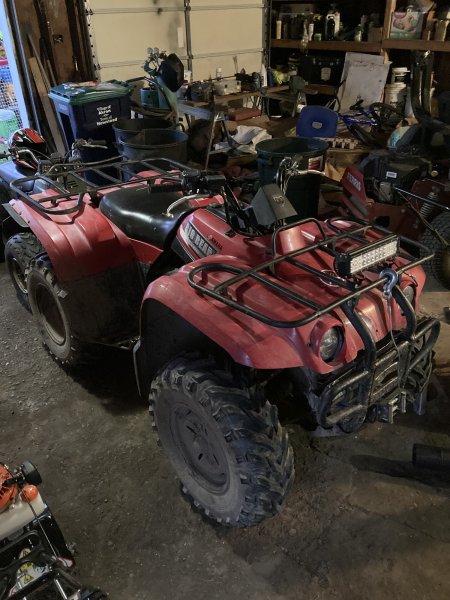

    I recently picked up a Yamaha Big Bear for myself, it needs some odds and ends too.

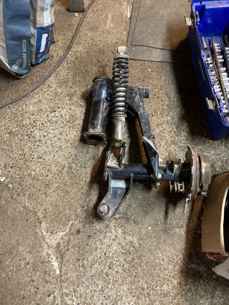

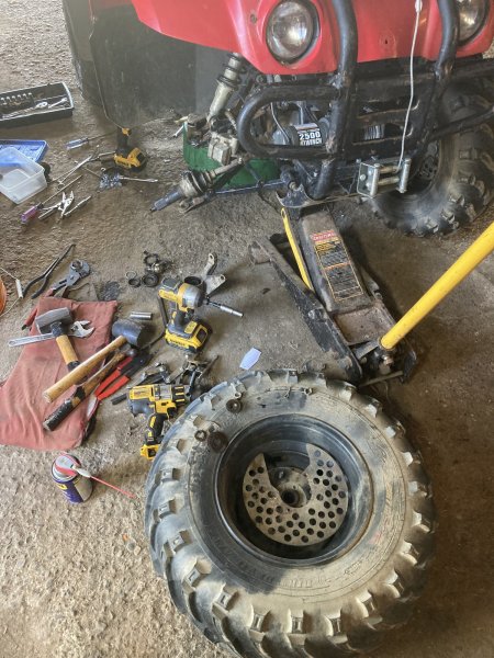

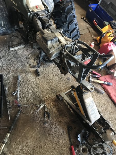

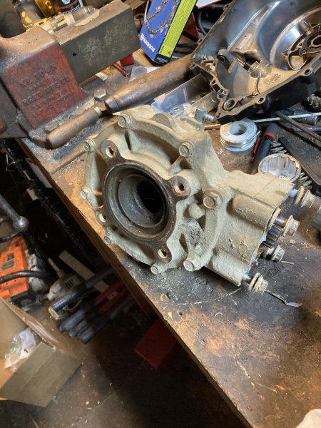

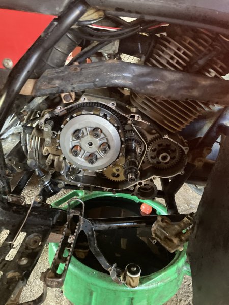

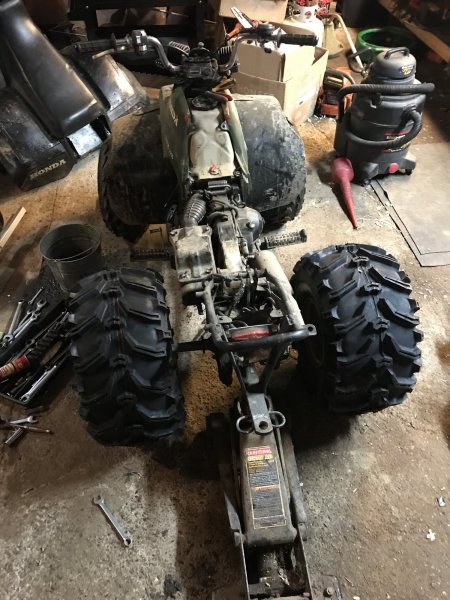

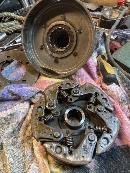

    Tore into things yesterday. New front bearings and seals done. Found a ball joint with a bent stud so that’s on order. Opened up the clutch case. Got new secondary plate and springs coming along with primary springs. 80695393-93E1-439E-AD9E-51B8967942DE.jpeg 054627E1-0994-4C9E-BE82-987A05F0468B.jpeg 16ECAE5C-0654-450B-8376-375EE2DBA2BA.jpeg
    Got at the rear end this morning. Brakes,seals and bearings all the way across along with a new shock. 56B3BAB9-C6C1-4B93-B44C-11CB683E17A5.jpeg 3E02F818-5FA3-41FE-A2D8-01D68E9D32B6.jpeg

    What was the issue there? Those typically have a VERY low failure rate.
    New bearings/seals in the diff too? Those typically have a high failure rate...people just don't drain the oil after goin swampin :headbang:

    The springs in the primary seem a bit week and the plates in the secondary are a bit thin and had some of the clutch material melted near the outside edges. My guess is abuse and wrong oil being wet clutches.
    As far as the rear. The outer seals were chewed up and letting in more than they were keeping out. Luckily only the outer seals and bearings were bad. Everything internal was nice aside from the milky oil.

    Based on engagement RPM? Or maybe "dragging" at idle?
    I have seen toasted frictions caused by a little kid riding the machine...too small to shift so they would ride around in second or third gear...which is VERY hard on the centrifugal clutch when taking off from a dead stop! Good way to burn the oil and plug the filter too!
    Caught it just in time then...lucky! :yes: That doesn't happen very often.

    Low rpm engagement. She slams in and try’s to creep even after turning the idle speed wayyyy down.

    Well it’s alive!! Little snafu this morning. Got everything together but it would t move!! After a little thinking I pulled the side cover and looked at the clutch. I had replaced all the plates and managed to put the pressure plate on one slot off!!!! No grippy there! I moved it to the right spot lining up the tiny arrow and good to go! F1B7C87E-5591-46A1-BE0E-F4414C1BE6E1.jpeg
