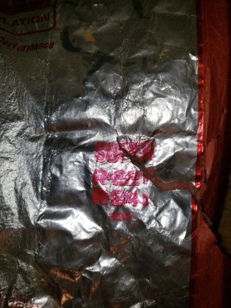

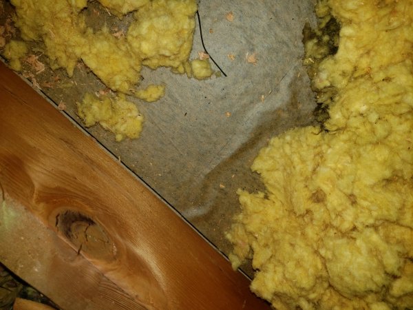

    Looks like there is already a paper vapor barrier laying on top of the sheet rock. Then some yellow loose wool material and some fiberglass batts with a foil backing on top of that with foil facing up towards roof. So essentially two vapor barriers which from my reading isn't proper.
    Just re looking at it all it's a beast of a job just shy of 1000sqft not to mention cost. Need to rethink this maybe reuse some of old stuff. Thought was R11 or R13 but actually R22 plus the loose material. Just gonna be a pita to air seal.

    If that gets torn or cut, use some tape (not duct tape) to seal. It's not really laying on top of the rock, but stapled on the face or just inside the 2X.

    I would but I simply don't trust anyone but of course there are exceptions. I have seen and heard about so many crap jobs being done especially in insulation. Why pay for a half bleep job when I can do a better than half bleep job myself with a little time and effort. They come in and blow over top of what you have and that's it. Who's going wading around in a sea of loose insulation to ensure they air sealed everything and covered all the can lights properly? I just have peace of mind knowing what I did up there.

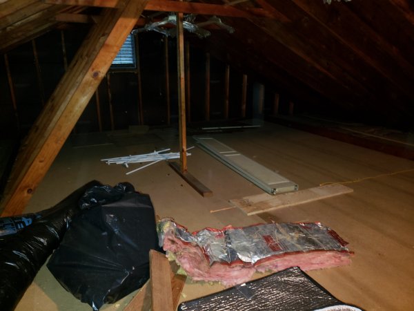

    This is a walk up attic, very big and spacious so it's not as bad as you maybe thinking. My knees are good and I am still fairly young and fit at 41. The problem am having wrapping my head around is the space that needs to be done, just shy of 1000 sq ft.
    Wasn't aware I had loose insulation along with batts that are R22/24 so for cost wise I may re-use what I already have between the joists and go perpendicular with a roll of fiberglass or blown in. But being what's already there going to be a pita to air seal. O and did I mention there is particle board covering half the attic space that needs to be ripped up, yes fun!

    Thanks papadave I too saw a few videos on youtube of them doing the same thing sucking out the old. I have another attic above our kitchen, dinning, and living room :headbang:.... about half the size. They have can lights and man I can feel the air being sucked out last winter.
    Working up the courage to tackle this, don't want it to be one of those started and never finished but I realize anything I start and do will be an improvement and I can take my time & do what I can when I can :yes:

    A lot of leakage occurs at the top plates of walls. Obviously, any penetration as well. If you see dark areas on fiberglass, it's a good sign of air leakage. (Fiberglass doesn't really stop air flow much).

    looks like the attic in the house I am restoring now. I am 6'2 and can walk around the whole thing 12/12 hip roof 1900 house. With 4' knee walls I can probably put a 20x20 room up there.
