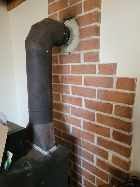

    Old stove has 8 inch pipe up to the T going into chimney, so I need to get some 6 inch. Is single walled interior stove pipe all the same? As in is a piece from tractor supply or Lowes just as good as ordering from a stove supply place? Anything special I should look for or avoid?
    I need to measure the height of chimney from T to top, in case that leads to any suggestions from yall. But I have 2 90's...the one in the T and the other above the stove.... Should I try to replace the one 90 with 2 45's, if room (distance-placement of stove) allows?

    I can’t speak to the single wall, but the double wall I bought from Menards 7 odd years ago has held up. Very well. I’d say your fine getting it wherever you can find it.

    Only reason I asked about single is because I've seen it said that helps give heat to the room as well, and that double is best for outside...? Perhaps I misunderstood part or all of that, or didn't get the concept correct.

    Yeah IMO all single wall is pretty much cheap junk...will last for a few years, then need replaced...less so if not in the basement, like my furnace setup is...buy doublewall though...the inner layer is stainless and will last you a long time...and yes to the (2) 45*s...if you have the room for it...unless you have a real tall 6" lined/insulated chimney, then it may not matter much...
