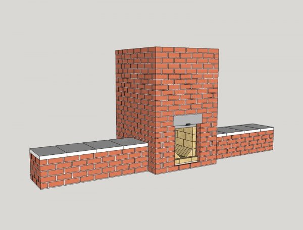

    I’m building one of these plus a 55 gallon barrel rocket heater for a guy in North Carolina next week:
    Batchrocket.eu - Applications
    For Code/zoning purposes it’s technically a masonry stove (which will usually pass code and homeowner insurance regulations) but it uses a rocket heater core. They’re really efficient because they creatE an extremely hot (2200•F) burn but for a shorter time than a regular wood stove. The secret is capturing that heat in a masonry bench which absorbs the heat then gives it off slowly many hours after the fire goes out. They do use less wood per season than a wood stove, but the difference is a matter of debate.
    Since we’re building on a slab foundation, , in front of an existing fireplace, weight and chimney is not an issue, but in a typical American home with a basement, it is a big issue to build one of these on the first floor. A foundation must be built up from the basement to support the weight. 577899DD-2188-4361-87AA-11B91665330E.jpeg

    A properly built and insulated rocket heater core will hit 2100-2200•F, which is hot enough to burn the Firewood and reburn all the volatiles and particulates in the smoke with only natural air draft and no catalytic combustors. So from an environmental perspective they have a lot going for them.
    All the volatiles necessary to form creosote are incinerated so creosote accumulation isn’t a concern, and the exhaust stream can run as low as 180-220•F, thus keeping a lot more of the BTUs inside the house and not being sent up the chimney. These two facts account for much of the claimed greater efficiency and incredibly clean exhaust.

  17. BrianK
    BrianK
    3,050
    10,784
    West central PA
    There is some validity to the claim that Rocket Heaters extract a much higher percentage of available BTUs per pound of firewood, and that the efficiency in capturing and releasing those BTUs is much higher with a rocket heater because the exhaust stream is relatively cool. I think in the end it could be validly argued that they use less than half as much wood as a highly efficient hybrid stove like my Ideal Steel, but only because the mass extracts every last BTU of heat available, and they are more efficient at reburning the smoke than the most efficient hybrid wood stoves.
