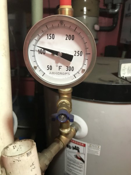

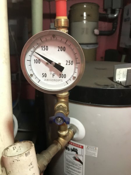

    The water was hot yesterday morning and not as hot this morning and really not hot later in the day. So I just checked the hot water pipe exiting the SuperStor and it was only 90 Degs F ?

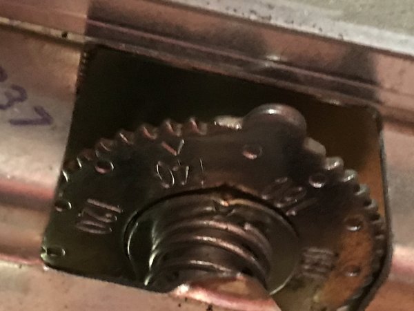

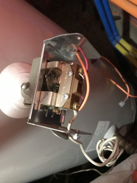

    So for troubleshooting, I connected my jumper to bypass the the SuperStor Aquastat and the DHW circulator came on and the boiler fired right up!
    So I turned the spring aquastat up a little higher and it came on. Looks like it is set to 140 Degs F?
    Anyone know what a good fix is? Clean the probe?

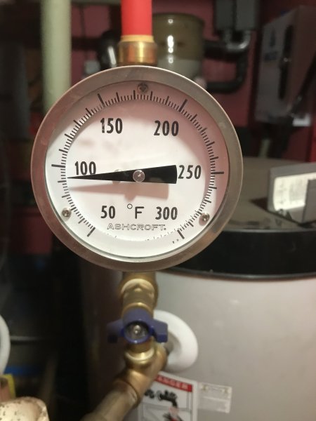

    It was maybe 135 and now that I set it to 140 it reads 110 this afternoon?

    I just ran the hot water faucet for a min and it went up to 120??

    After the adjustment I made it seems much better, maybe the spring in the aquastat was stuck after 11 months of being shut down?
