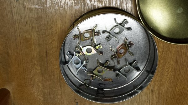

Anyone know what these are??

    The little tin was given to me with some other engine related stuff - not sure what they are - anyone know? Thanks! Cheers!

  2. Grizzly Adam
    Grizzly Adam Guest
    Looks like springamajigs.
  3. Pyroholic
    Pyroholic
    880
    3,038
    mid michigan
    Just guessing, but maybe part of a mechanical advance for a distributor.
  4. lukem
    11,826
    63,205
    Close. Actually they are springamabobs.
  5. papadave
    Confibulator clamp
    Final answer

  6. papadave
    Wait, I recant my final answer and now I think it's a medieval torture device.
  7. lukem
    11,826
    63,205
    Muffler bearings .
  8. Horkn
    28,526
    161,313
    That's exactly what they look like to me.

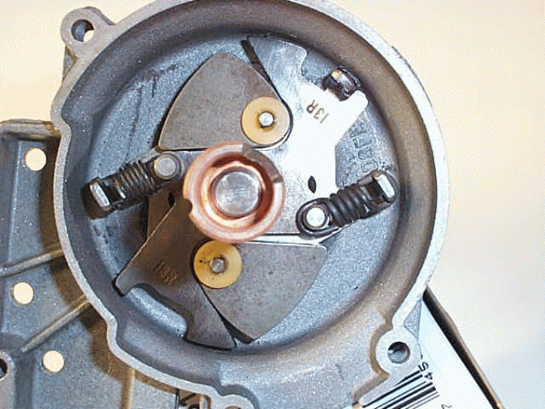

  9. Horkn
    28,526
    161,313
    Ok, that's not it. This is what those look like.

  10. Horkn
    28,526
    161,313
    It's gotta be a clutch damper , vibration damper, or something like that. I've seen them before. I just can't determine where.

  11. Scotty Overkill
    9,608
    64,456
    I can tell you EXACTLY what they are.....they are old starter clutch pawls for older Stihl saws (041, 051, 075, 076 series, to name a few).

  12. Grizzly Adam
    Grizzly Adam Guest
    Yeah, springamajigs like I said.
  13. Horkn
    28,526
    161,313
    Now that makes sense.

  18. NH_Wood
    NH_Wood
    May 11, 2014
    1,265
    4,219
    Thanks Scotty! Appreciate it! Cheers!
