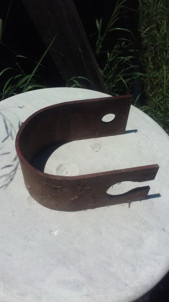

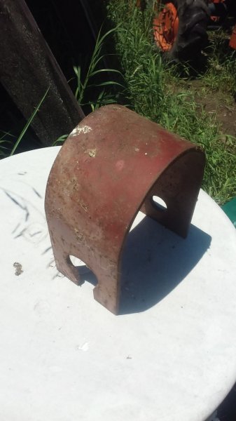

    I've got one similar to that it works pretty good. It is a balancing act at times. I have a U-shaped piece of steel that a peavey slides thru it has a hole in one side and a slot on the other it works well and you still have use the peavey when needed. I'll post a pic' when I get one.

    Here it is
    20170702_141734.jpg 20170702_141750.jpg I don't have a peavey at this time but you get the idea!

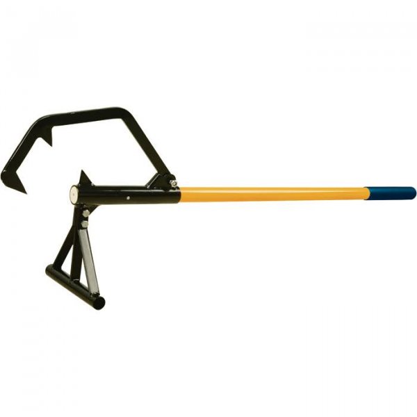

    I bought something similar to this timberjack this year, except mine is green. It's solid and I'm able to lift lift the logs off the ground, but will have to reposition it a few times for each log. Keep in mind, most trees on my property aren't very large. It does tip when on uneven ground (which is often for me), forcing me to try it a time or two before getting it just right. Despite having this tool, I only use it about 50-60% of the time. The other times I will cut 3/4 through the log, then roll the log to finish the cut, or I'll lift it with the tractor and a chain. shopping.jpg
