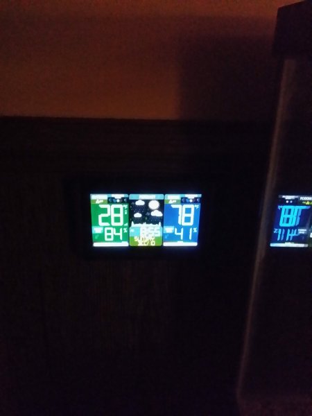

    This is from a couple of nights ago...I always crank my King to high when I head upstairs to out the kids down for the night...it's usually around 78 after I shower and head back down for beerverages and TV; that night I had loaded with Mulberry and cranked 'we up. Oops!
