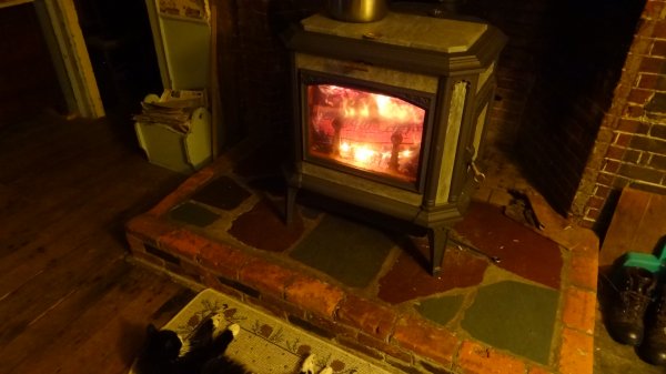

    In this weather and this house, a 400 degree stovetop means someone was slacking. I am envious of a house that doesn't need a 550 degree PH, but it is designed to do this day after day.
    Here she is, climbing back up past 450, with flue probe at 400.

    And a few minutes later, still below 500, but a lot of heat off the front with active secondaries, ...
    Both the IS and PH can do this. The PH throws a bit more heat off the front on the high end, the IS excels at the mid to lower range.
