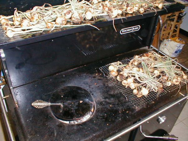

    Drying Onions 2012 2.JPG Dries my onions

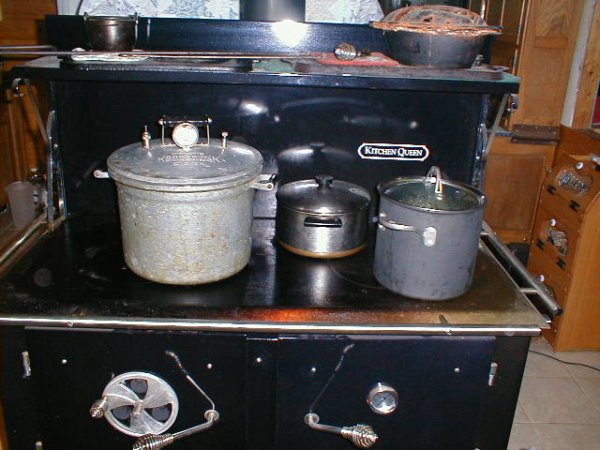

    P1010037.JPG Canning

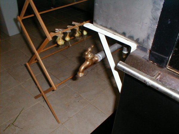

    Hot Water Faucet 1.JPG 25 gallons hot water

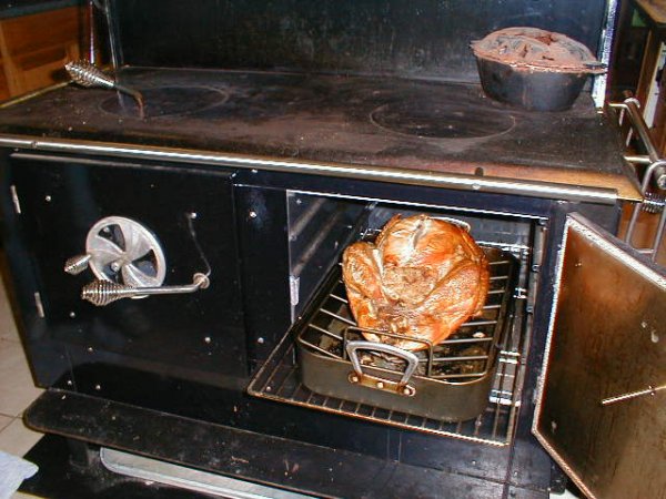

    Thanksgiving 2013.JPG Dinner

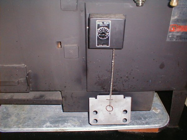

    I added this thermostat before they were optional. Instant ignition with under fire air, also allows coal use.

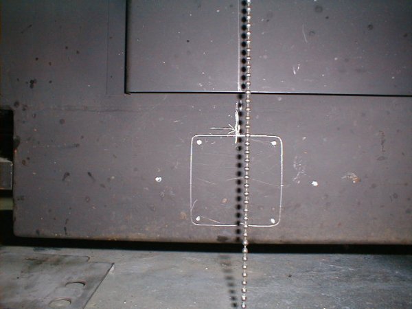

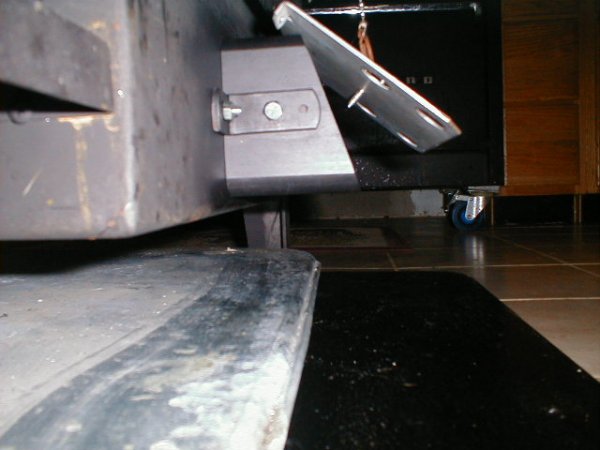

    Here are the pictures I took when adding the thermostat back in November 2015. ALL my references in above posts are for the Queen model.
    I mounted the thermostat housing so the chain was centered in the ash pan rear wall area.
    Centered intake opening with chain from thermostat.
    T Stat Install 4.JPG Drilling corner holes.
    Sawzall ready to connect the dots.
    1/2 inch thick square tube mounted with angle brackets.
    T Stat Intake 4.JPG Side view shutter open.

    I couldn't help but notice your bi-metallic door flap has 4 fairly large holes drilled in it. This means you always have some under-fire air coming in, correct? Of course, you're burning wood mostly with this stove, but many Hitzer users (and D.S.M.) use a similar technique when burning coal to maintain a slow and low stove temperature; they use a paper clip. I'm sure you're probably aware of this, and obviously the wood would need more air to maintain the lowest burn you choose.

    No, the holes in the door flap are outside of the intake opening it seals. Closed allows no air flow.
    That plate was from a baffle type partition in a microwave oven. I didn't cut it down to eliminate the holes because I liked the weight of the flap using gravity to securely close it. It was just the right gauge, not flimsy and flat for a good seal.
    Like older Hitzer's, when t-stat closes, it requires a small intake elsewhere under grate to admit low fire air. Easiest place on a Queen is the ash door using a Fisher style intake damper. I do have a Hitzer EZ-FLO hopper style stove for a break from wood heat some years. It is a much more even heat, and I don't always have enough wood dried ahead of time. with no thermostatically controlled heat source in my home it also serves well if we have to be away for longer period of time than the wood stove allows.
    I find using the low fire manually to maintain house temperature is much more efficient on fuel than using a thermostat that burns hard when it's open, allowing cool down while closed. My t-stat on the Hitzer only opens when starting, or in need to save the fire, or bring house temp up after a long period between shaking.
    The t-stat on the Queen ignites this thing like a light bulb. Instant flame when kindling.

    Ok...it was a little harder to see at first, but after looking again and studying the photo I can see the flap is wider than by a good bit than the intake. That's why I thought the holes were allowing air through. Glad you pointed that out. That's likely a better flapper than the Hitzer. The D.S. Machine flapper is cast...and really nice.
