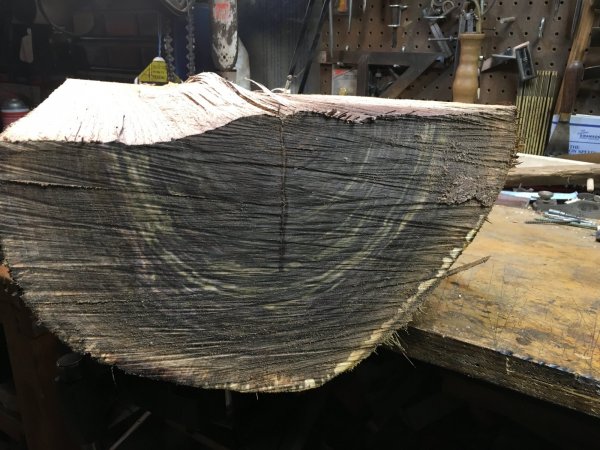

    Cut a round and split it in two halves a couple weeks ago to start a large bowl. Finally got to working on it last night, and a bit today.
    Having let it sit longer than intended after splitting it, it started to check on one end but not too bad. It should all get removed as I progress, I hope. This one being done "bark up" I needed to get rid of the pith section and flatten the bottom to make the layout & roughing work easier.

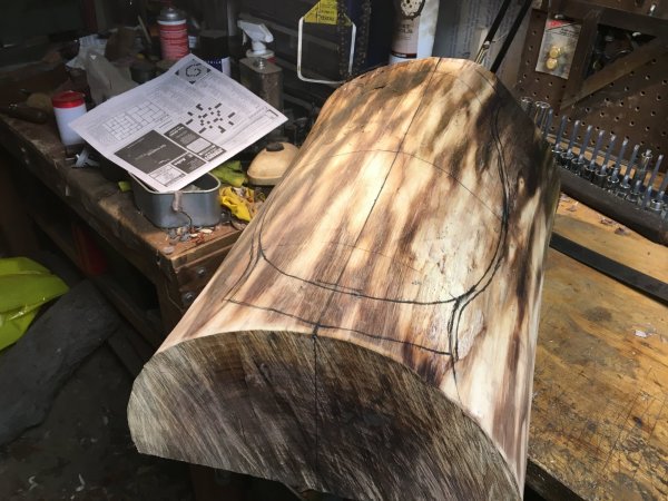

    That done, inner bark stripped off and a layout of the rough outlines.

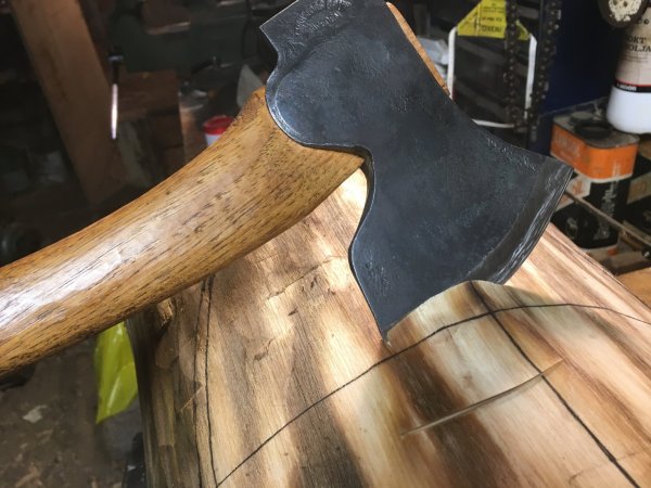

    A bit of a stall to rework the bevels on the Granfors Bruk Carving Axe.

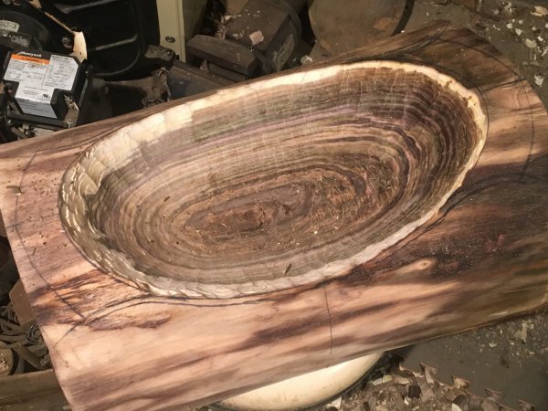

    Then on to the adze work. The color & grain is starting to dazzle already!

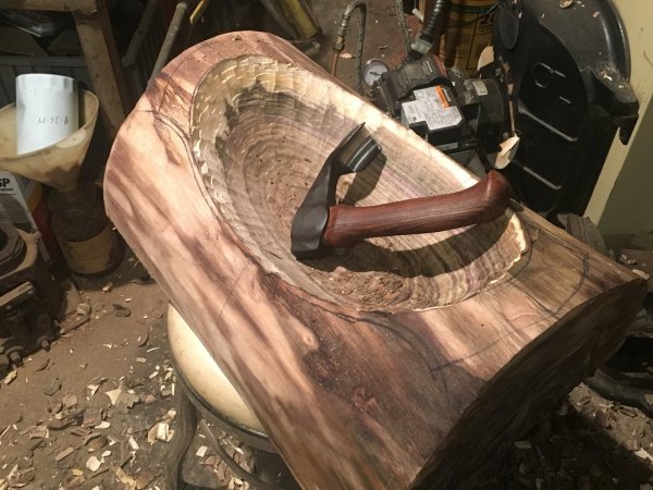

    Was able to spend a couple more enjoyable hours finishing the roughing out of the interior tonight. I've the feeling my triceps are going to be sore as hell tomorrow. It's a bigun! But really happy with how this is looking so far.
