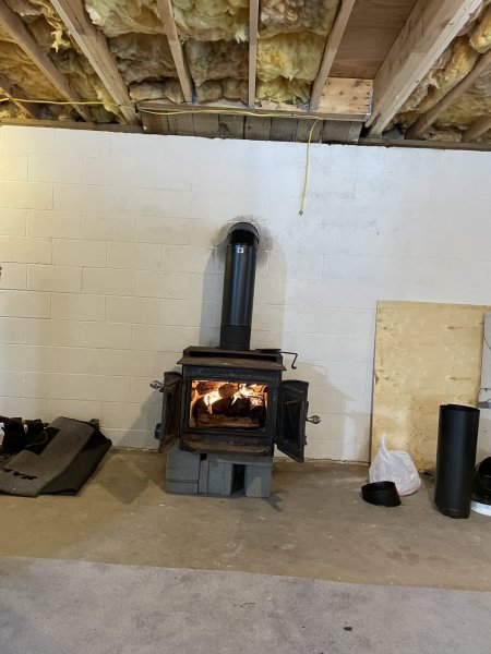

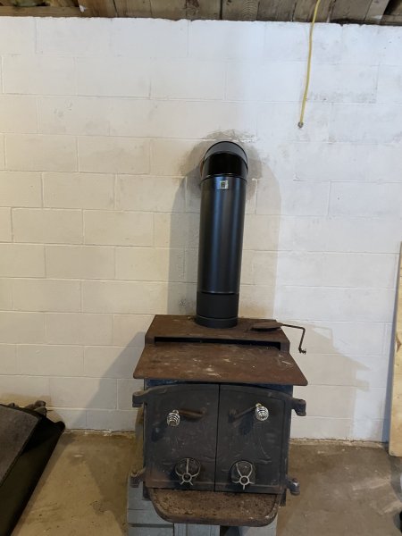

  19. Anthony Azzara
    Anthony Azzara
    Dec 6, 2021
    18
    22
    Hawley, PA
    Here are some pics.

    So just a final update to close this thread.
    This weekend we saw temps in the single digits. Before getting the stove lit, the basement was 42°. Upstairs I was running the BK insert full crank. And the temps were around 68.
    Once the Fisher was going a few hours, the basement was 70° and upstairs with the basement door open was 72° . I was also able to turn the BK insert down a bunch. I will say this is a success!
