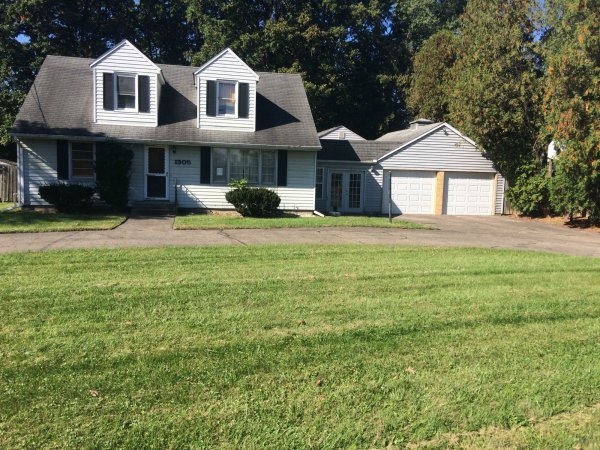

    well just finished up with a realtor, the house in the above picture which I was working on, is on a commercial lot. His buyer made me an offer and I could not pass it up. The house will be torn down and a gas station is going in. I am sad because when I bought this house I was originally going to keep it, that has since changed. The house sits on 1/2 acre and is 5 bedroom 2.5 bath with the garage you see and another 28x32 in the back. All real oak hardwood floors. Ah. progress.
