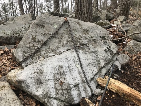

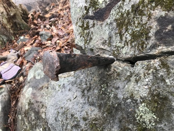

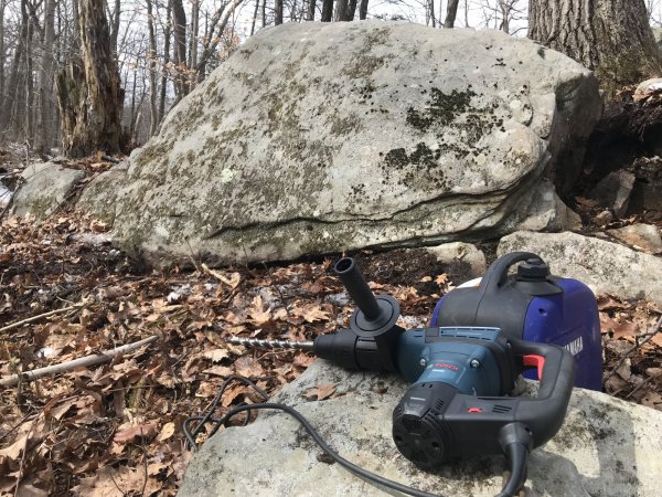

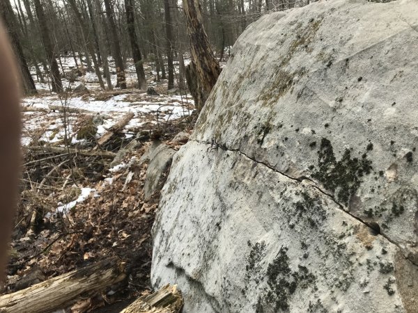

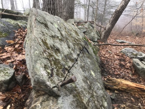

    I have used a wood splitting wedge to finish off a cutting a rock slab. (And my chains came from a logging supply company).
    One gigantic rock slab, drilled and split with feathers and wedges
    CD1F9426-903A-4D73-AD88-4CE055695F78.jpeg 7D3B304C-BD8F-4BA2-A4BD-CDED3BC3FB45.jpeg 8BBF42C3-E8EB-4D29-82D6-8349A06CFF55.jpeg
    I couldn’t get the two halves apart. Thought about it for a few weeks and went back with a wood splitting wedge. Took a minute.

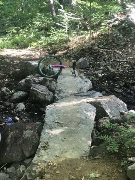

    And they became a hardened ford over a stream.

    You towed those rocks into place with a bicycle? I’m impressed LOL
    Nice job. I like the end result. Just a hobby project or do you play with stone for a living?

    The project was originally all volunteer. As time went on the chief architect got a job with a professional trail building company. So now, depending on fundraising we get machines in twice a year to rough out sections that we finish with volunteers.
    That rock was split by me as a hobby/volunteer and put into place with a mini-ex on paid time. I wasn’t there that day to get a photo of the action. He said the slabs were at the cusp being to heavy to push around by machine. I was dragging them with a 2 ton grip hoist.
    I get in as good grin every time I go across it.

    It looks like you drilled 14 holes. Is that correct? Can you provide more details on what feathers and wedges you used for this project and the diameter of the holes drilled? Thanks..
