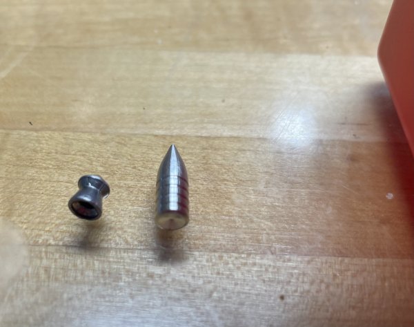

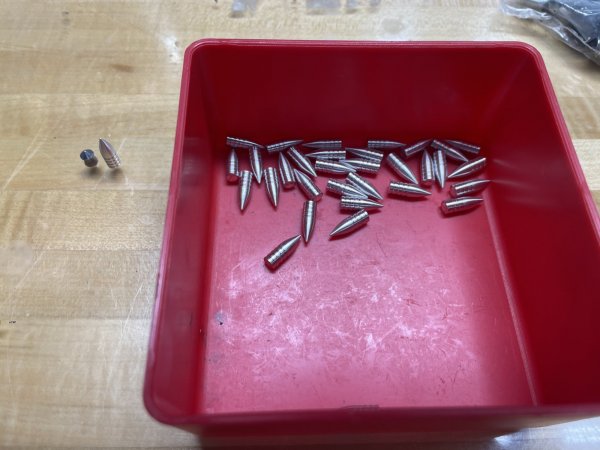

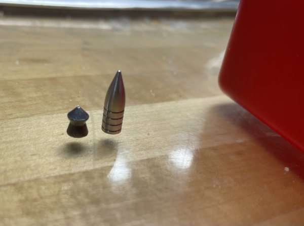

    Homemade 0.177 caliber pellets. I’m not sure what to expect, but it should be fun :) The off the shelf Daisy pellets weighed in at exactly 0.5 grams on the scale, and my CNC turned aluminum pellets came in at about 0.4 grams, despite having quite a bit more mass. I’m hoping they have some serious penetrating power. I’ll give you guys an update after I try them out.

    Thanks. I'm a little nervous about the aluminum galling up the barrel, but I figured it's worth a shot (or 33). The aluminum is 7075 grade which is on the hard side, as far as aluminum alloys go. I have some copper I can try out on the next batch too.

    Update: I’m going to have to change the geometry on the O.D. of the pellet. Although I was able to accurately hold the size to match the Daisy pellets, because of the length of engagement when it hits the rifling, and harder pellet material, it jams halfway through the barrel. What I’m going to do is leave a narrow band of engagement in the front and rear of the pellet to catch the rifling. What I did from the start was turn a tapered pellet that was 0.176 at the front and 0.177 at the rear, and add 4 grooves along the O.D. thinking it would be enough clearance. Obviously I need a little more. Not a huge deal since I still have the machine set up :) Redo my geometry, load a new program and try again tomorrow.

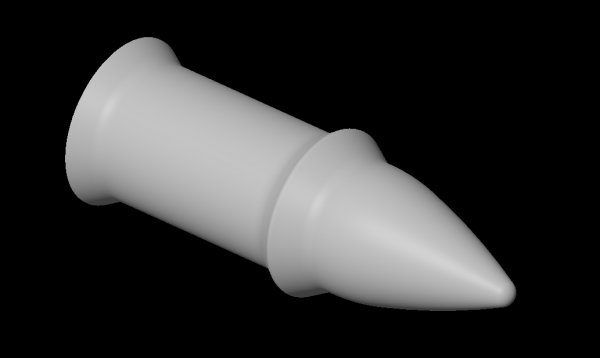

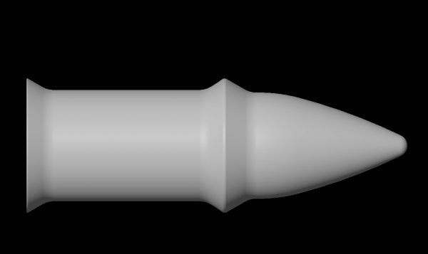

  17. Eric Wanderweg
    7,857
    61,607
    It’s just a cheap Crosman single shot break barrel, nothing fancy.
  18. Eric Wanderweg
    7,857
    61,607
    I was thinking 6061 would be better myself. All I had on hand in 1/4” round stock was 7075, so that’s what I ran with. The nose of the pellet has a 0.015” radius on it as it is, so it’s reasonably sharp. I agree there’s too much drag. Doing a secondary turning/drilling/boring operation on the back side will be tricky after I relieve the middle of the OD. Not much to hold by. The best approach might be flaring out the backside with a punch until I get the right diameter, which will take quite a bit of experimentation on my part. I’ll see what I can do though, thanks.
    KSPlainsman and brenndatomu like this.
  19. Eric Wanderweg
    7,857
    61,607
    New design done, waiting for an open machine to run off half a dozen in :whistle:
