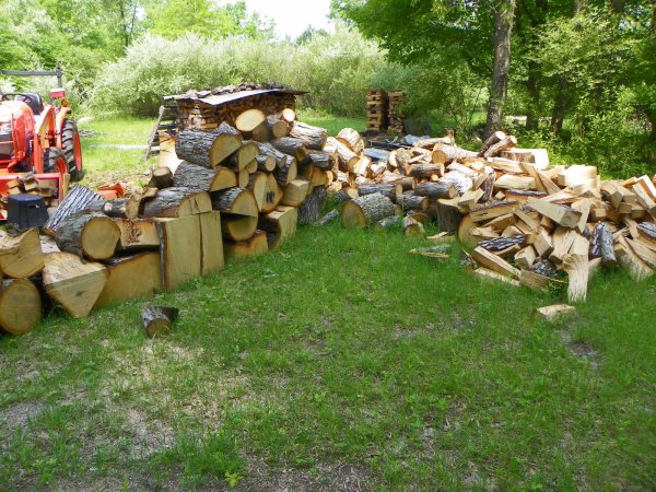

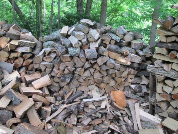

    Notice the stack of large rounds; some have been noodled. The reason we stacked them (not neat but stacked) is so that we can just place the splitter right next to the stack so the big blocks do not have to be moved far to get to the splitter. It helps.
    Normally we do not throw wood into a pile like on the right but this wood was not cut on our place and we also had some help from other people. I did not feel right in asking others to stack the wood when they threw it off their trucks. So, I have some work ahead of me.

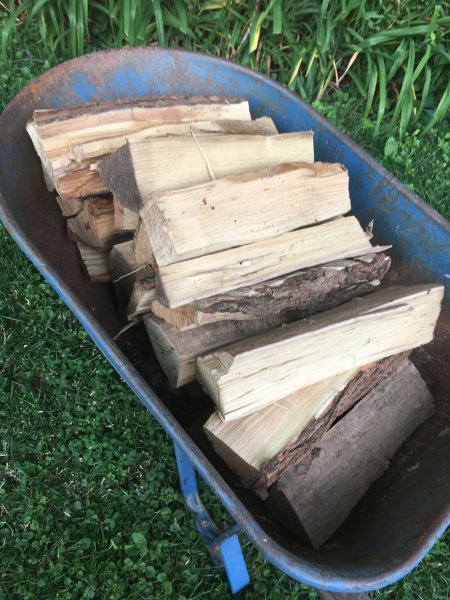

    F09B1408-B2E5-4764-B9CE-E0231D3783D5.jpeg 8E73D693-B77A-47D0-9DF1-2928A648DBE1.jpeg 836E93D8-AC69-4674-A0A4-33BF8D2B390D.jpeg I took the saw for a test run and made some progress on my backlog. Wheel barrel of locust and what I thought was locust then thought it might be elm, but then it split and looks just like the locust on the inside, so i’m Thinking it is locust again. Red maple with a little rot and ants in the middle some cherry with some different ants at the bottom of the pile.
    I tried noodling a red oak and cherry, uglys with mixed success. Got most of the way through but haven’t tried splitting yet.
    All this to say not sure i’m Feeling the silver maple tomorrow. I kind of feel like taking some of these uglys back to the firewood dump.. it was hot today.

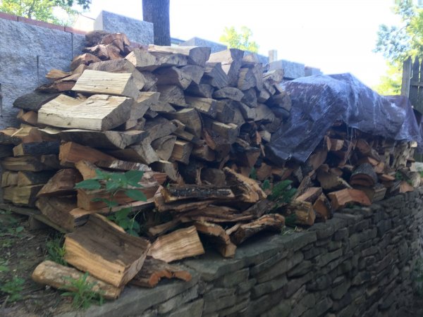

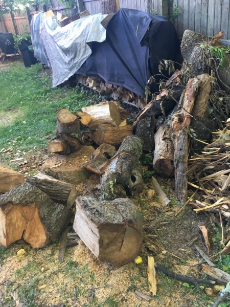

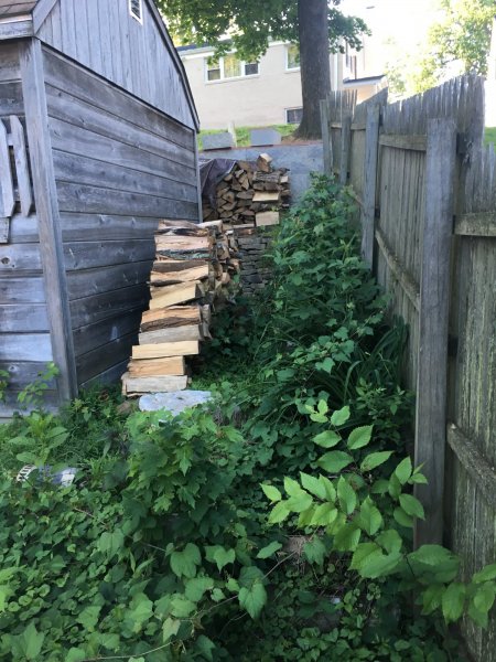

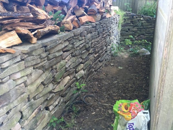

    9E4239E1-EBCA-4C96-8272-C357D1F19E0B.jpeg 0E0C8B99-D6A8-4B75-A7D9-8AB97C8EF1AE.jpeg 2EF585B3-5910-44FE-A79A-C17221204E5C.jpeg FDD036E9-2231-43FA-A084-3E354B88A670.jpeg 227E4BC7-A705-4127-A3D9-D5768C9C7FBB.jpeg I’m seeing a couple more places I could stack. Make the shed side stack a double wide. Add another pallet to the back shed stack. And I could put some rounds down low behind the shed.
    I need another wack at the ugly pile before I give up on them.. the last of the cherry is cut and ready to split there too. You can see my attempt at noodling the red oak crotch that wouldn’t split.

    I like the stacks on the retaining wall! Behind the shed, not so much. It looks like it could get pretty dank back there. You've almost got that oak crotch! Just knock it here, and here. aviary-image-1559657181954.jpeg

    Down low behind the retaining wall is pretty dank, but out of site staging for rounds was what I was thinking. Maybe I can start a mushroom farm if I take too long.
    The retaining wall is also behind the shed but it does get more wind and sun up there. Beside the shed gets the most sun.
    Thanks for the pointer on the oak; i’m Looking forward to taking another whack at it.

    I really don't like stacking wood like that. When it is up against a wall, how can it get air through the stack to dry the wood? You could do better if you could stack in the open and don't be afraid to stack several rows together. Some worry about doing that and I used to but no more. I've stacked numerous rows together even in areas with no sun so long as they get some wind and the wood dries very nicely. But stack where it won't get a breeze and you are many times asking for problems. Besides, isn't your state one of those where lots of rain falls? Could be a problem. Also, when covering the wood, try to get the cover so there are no pockets for water to pool. When using tarps, you could lay some boards or osb on top of the wood then cover it with a tarp. Just be sure on the ends where the water will go. Don't let water fall from one stack onto another, for instance.
  17. jo191145
    jo191145
    6,112
    40,697
    Ct
    Masonry is moisture ;)
    Not to mention lack of air as backwoods suggested. At least stack/lean a pallet against that retaining wall first to allow a little separation.
    Many people here stack single. Me I use pallets and pallets have room for two rows and I’m gonna use that room. Never had a problem with double stacks. Many years ago Dad and I decided to stack a huge solid square of firewood. About five pallets square for 25 pallets. Now that wasn’t a good idea. The center was all black mold and soaking wet. We never tried to pull a stunt like that again :)
